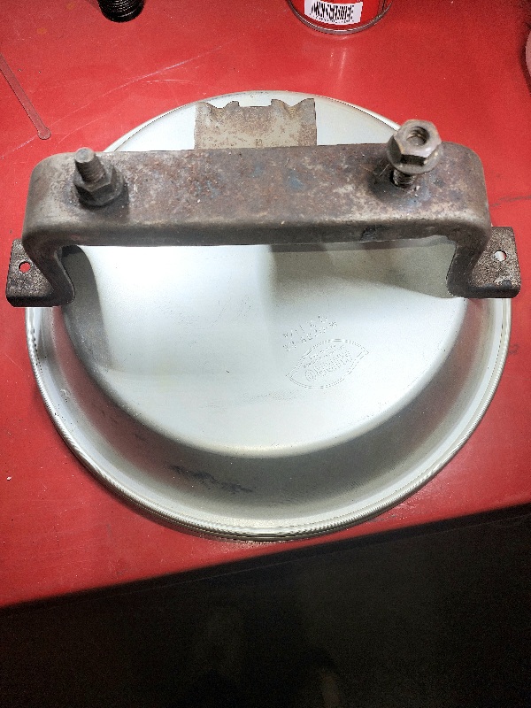

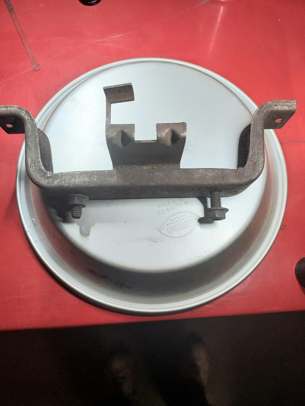

While looking for a battery hold down bracket, I found a box of items. Hoping to get some help in identifying them. What they are and year of usage. The black nylon strap has 2.75 and Patent 2,937,834 Thanx... Danny

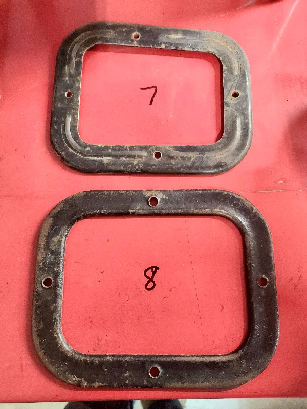

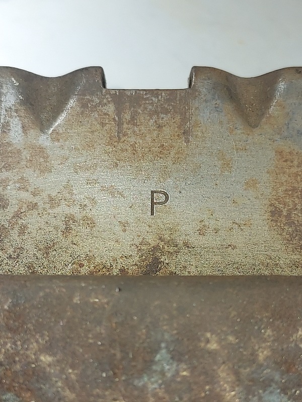

Looks like a console bracket, but don't know the year. Has a "P" stamp. Last 2 Shift boot brackets. But don't know the difference between the square and the offset one. Thanx... D

(no number on it) pic looks like the front bracket used to mount a floor console to the floor

Console bracket has no number in post. I have a couple console brackets but they don't have the upper center piece. I could be wrong, as they are not handy. So I was wondering the year.

#4 is a specific 68/69 Camaro front console bracket used only on cars with gauges.
The small upper section (on the top of the bracket base) is designed so the gauge package wiring harness has a place to be routed through. The only problem with yours is that somebody cut off one side of the top bracket.
