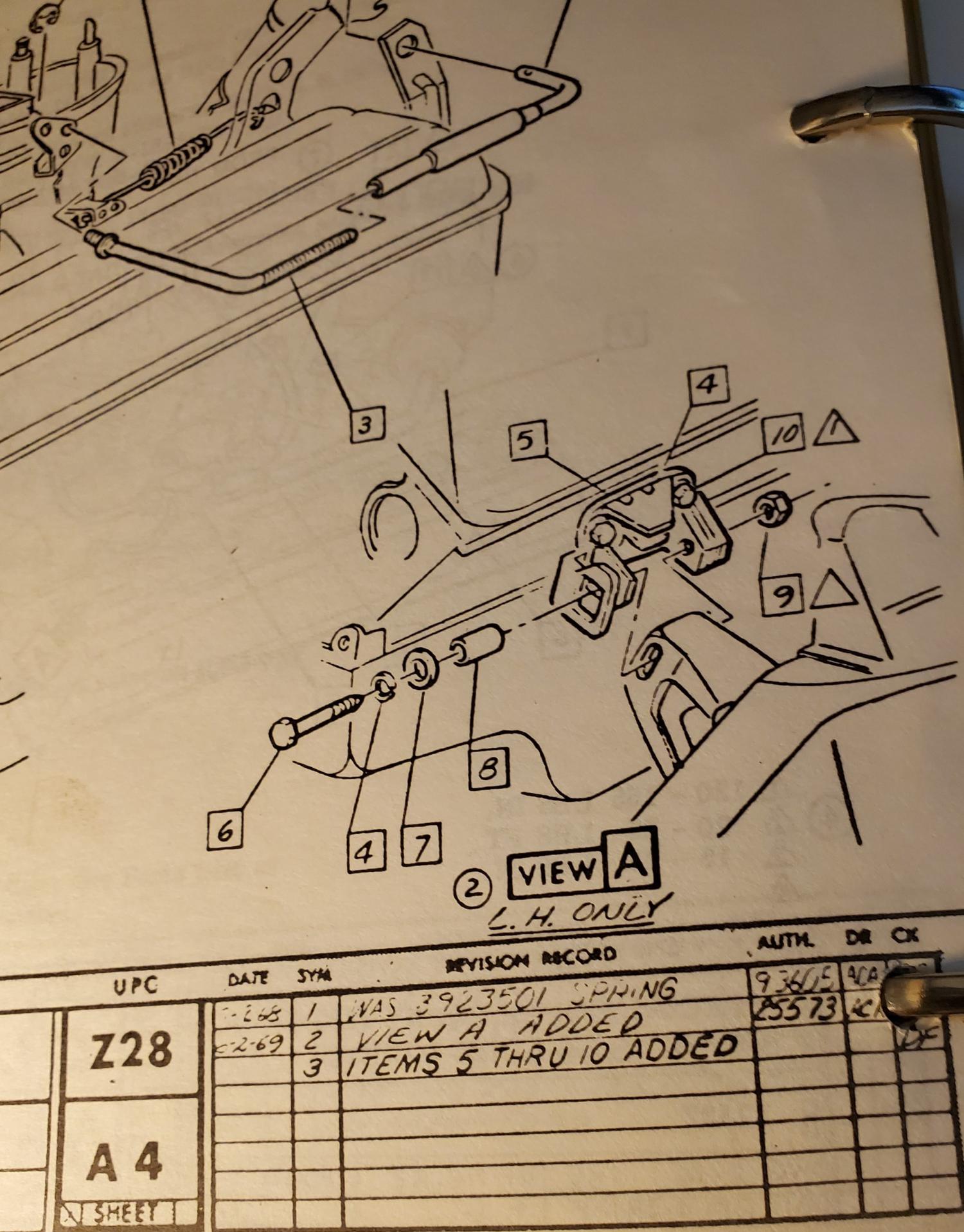

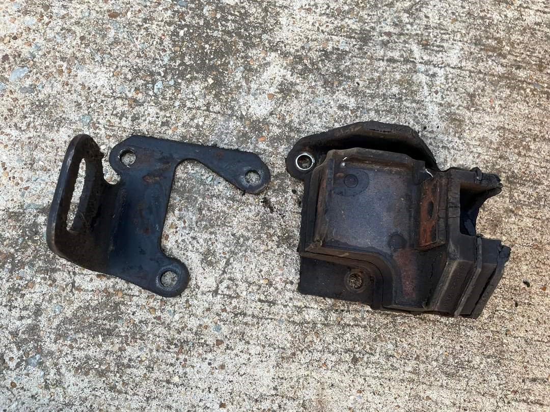

wondering if this was a production mount or when in production it started? I've never seen these in person - also any info on the bolt and spacer would be appreciated

That bracket is on upc Z28, sheet A4 in the AIM. It looks like it was drawn 8/2/1969. My 8/28/1969 had that same system even though it's a 396. Mounting bolts to the block are a thread or so longer on the driver side...Joe

THX X66 I saw that Heartbeat offers repro brackets for SB and BB but not the correct mounts, the longer mount bolts is understandable but I was curious about the long through bolt and spacer, washers any chance you can post some pics up? I'd love if anyone has dimensions available of spacer - length of through bolt OD of washer and thickness ect

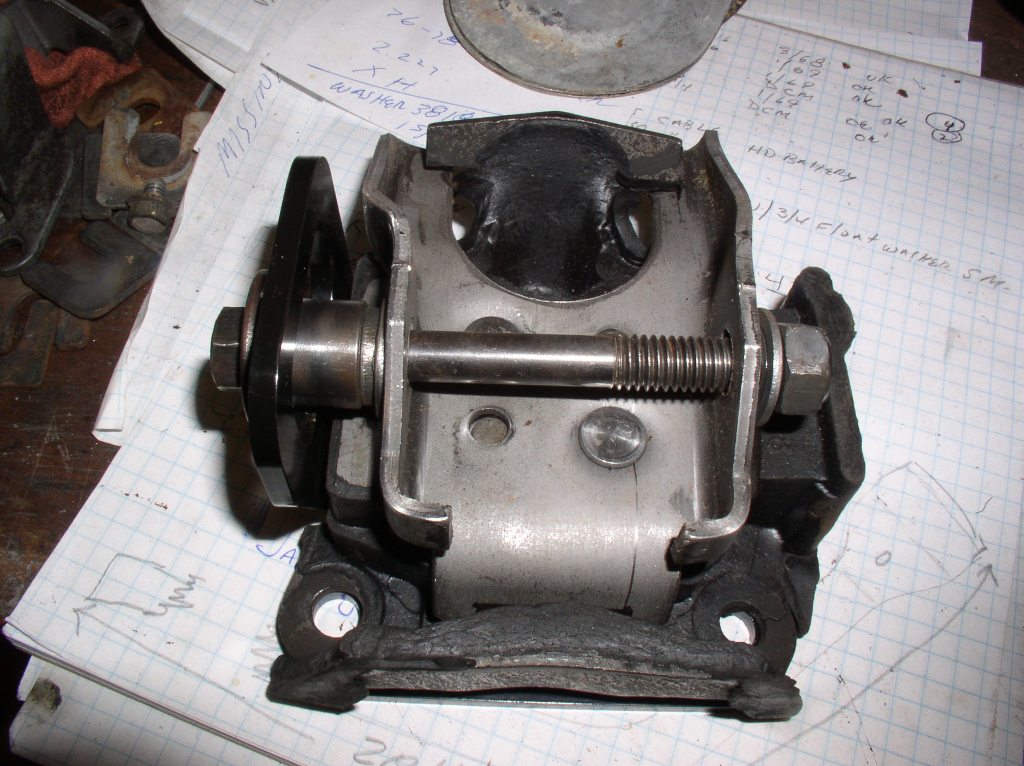

I cheated a little because I didn't want to spend 1,500.00 plus on original mounts. A copo, i would've. You have to put a bevel on one edge of the mount where it meets that bracket. I got the bolt from Rich who used to sell hdw here. I might have to take mine out to replace a freeze plug. Here's a picture of that I did. Real pieces are hard to find...Joe

That's in my car now, yes. I was comparing hdw between small block & big block. It seems to me that all the pieces were different. I'll have to go back & look. I also remember looking for the part numbers in AMK before I contacted Rich. I'll see if I can do some digging for sizes of hdw. I'm reaally surprised that somebody else hasn't chimed in about this system. If Warren was still with us (RIP), he would've been all over this....Joe

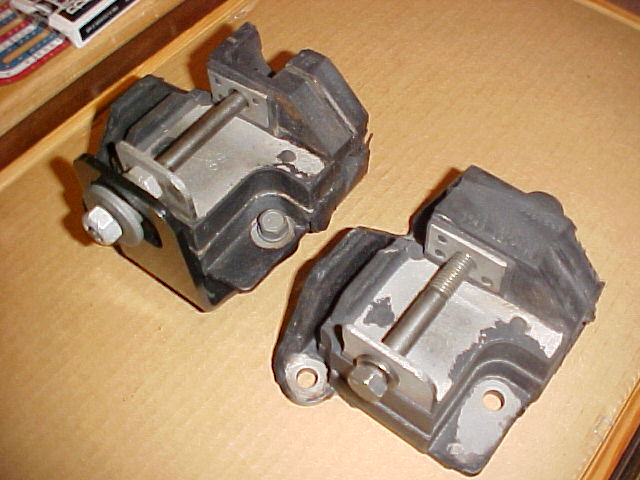

There is a post on CRG i was involved in regarding the original production mounts. Here is a picture of a original set of Z28 mounts i have, lift plate is a reproduction.
cool and I forgot to look on CRG -older age is great isn't it? -I found the thread there, was hoping for some measurements of through bolt spacer and washer if its handy? I have also reached out to Lloyd Edgemont as he was looking I'm pretty sure he has located it by now
