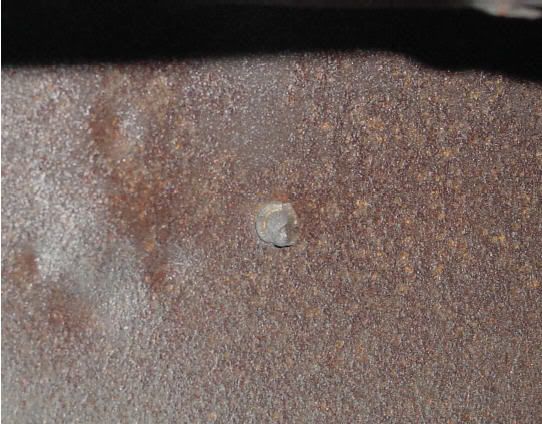

This may be the "post that leads to nowhere", but there was another discussion on this site mentioning the back side of the trim tag rivits. I have to tell you that I've never paid much attention to that feature, but it would be very difficult to reattach a trim tag and maintain the original factory look. Maybe a good discussion for documenting the originality of cars? Any thoughts? Here is one of the rivits on my burnish brown copo car.

If one is looking at a car for sale and you can get to it , bring your inspection mirror with you
It is not likley anyone will squeez a replacement rivet like a original.

There is no specification that I am aware of for squeezing a rivet, but if enough are studied you will find a trend of some sort that will differentiate an original from a fake.
The mirror method is an old school idea which does not lend itself to documenting the backside of TT. A fiber optic scope is the best method and will allow you photographically document the reverse side of trim tags.
Not to mention that it will also allow you to ID sections of firewall that have been transplanted with the intent to preserve original rivets.

Years ago I Did exactly that - trying to find a pattern when the first repop TT's came out. I Stomped around several salvage yards in the late 80's with a dental mirror. My conclusion was that because these cars were mass produced there was no time to worry about much more than if the rivit properly attached.
Additionally since there is no specification within the AIM for how the rivit is to be compressed - then there is no standardization. What you are left with is cosmetic variations.
As to the visual indicator of firewall transplantation I suppose you could observe that if the work is sloppy or seam sealer was not applied.
