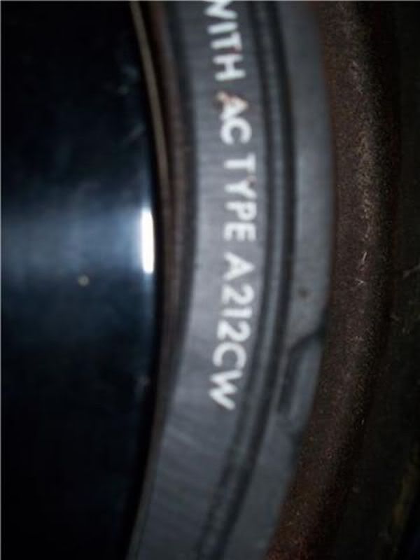

The flange for the seal (3975986) is 69 camaro and 70-72 Chevelle. The extension (3955233) is 69 Camaro. The air filter (A212CW) could also be worth some money.

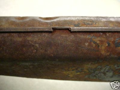

That 986 flat ring that the rubber ring attaches to was original to Chevelle (Camaro was oval shaped, Chevelle was round with one edge cut off), but Chevrolet later superceded it for use with Camaro also. The 233 extention ring is for use with a 302/Z28. Looks like he got at least three of the #233 extentions. Assembly line correct housings also had a notch in the seam on the side of the snorkel where it folded over.

Old 10-06-2009, 05:50 AM
John Brown's Avatar
Location: South Bend, Indiana
Posts: 2,820
Thanks: 455
Default Re: NOS Cowl Induction Air Cleaner Identification?
Picture of notch.
