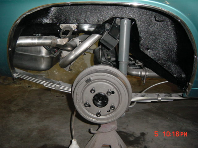

Can anyone breakdown the radiator tag. I plan on having it pressure checked, straighten the fins and thats all I think it needs. Oh, and get all the dog hair out of it, the radiator was just a mat of dog hair. Does anyone have a good radiator repair shop in the east valley, or Phoenix if no-one knows any good shops in the east valley.
BV rear, supposedly the original born with 4:10, 28 Mar Detroit and I can't read the last letter/number(does anyone know what it might be.. E below the date code designates a Eaton Poistraction diferential. I will try and get some better pics of the rear stamping when I get a chance.
Note the Chambered Exhaust:
69 Camaro 12 Bolt:
Dave
