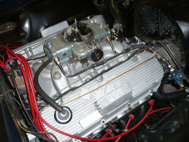

A Little back story.
My father purchased a 1967 RS/SS Camaro and has had it ever since. Original paint, original interior... 28,XXX Miles.
Around 1975 he went to Houston, Texas and bought from a guy an aluminum 427 block and matching heads from a 1968 or 69 Corvette, Manual Transmission but he can't remember the color of the Vette though.
He recently took the motor out to replace gaskets and to fix an oil leak and took some pictures for me.
Can you help identify this motor, I see it has the Winters Casting mark on the front of the block.

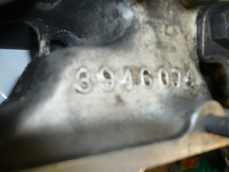

Engine is a ZL-1 and the heads are for L88's and ZL-1's from what I could find on the internet....what are the dates on the block and heads?

Where is the date on the block?
I know he said the guy removed the VIN from the block and put his own number on it but I told my dad he might be able to do some kind or acid etching to bring the original # back.... Like the police do to get serial #s off guns that have been filed off.
So it is a ZL-1 block, there were only like 70 of them made right?

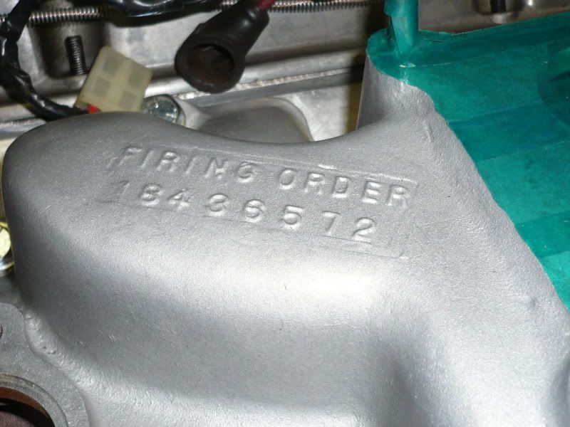

The intake does not match the ZL-1, we know that. It is some high flow intake with rectangular ports.

what is the casting number on the backside of the intake? You do have a factory intake there...the ZL1 intake will have numbers ending in 198 and is a rectangular port...the number you posted a picture of for the intake is the firing order.

Soooooo, who is going to omment on the 074 heads on this engine? Acording to the people in the know on the L89 Nova thread they were totally wrong for THAT engine. This should be a 12.5:1 engine with these 074 heads?????

Default Re: Can you help identify this Aluminum 427 engine
the 052 cast number means it was of the original design as opposed to a later GM block..there were many alum blocks made beside the original 'original' 69 that came in the cars...A few clues to look for. Does the block have screw-in freeze plugs..or press-in? Is there a small stamped 2 or digit number on the rear of the block in the center above the bell housing mounting flange..same number would be stamped on the main caps...a date code and small cast number may be located down on the side of the block near the motor mount area. Some of the known original ZL-1 blocks have the VIN stamped on the front pad and others have the VIN stamped down along side the oil filter. If it is one of the real blocks, you may have a small fortune there. Regardless, it is an awesome street motor!!! A few more pics may help. Good Luck.

074 heads are the only factory correct ZL1 heads...there is nothing wrong with those heads on this engine...yes, that is the correct advertised compression...
ZL1 = 427 cu in and L89 = 396 cu in....same stroke different bore, thus different pistons...

My Dad got that hood in 1968 if I remember correctly, just a fiberglass hood.
Here are some pics.
I will have him look if they are easy to spot.
BTW for those saying the heads don't work on the motor they have been on the motor for almost 40 years.
