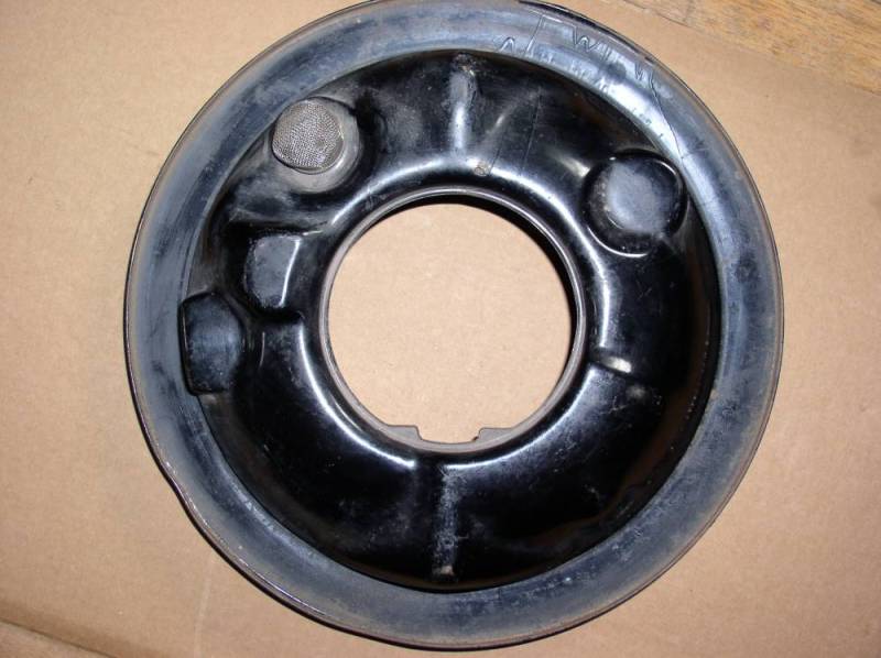

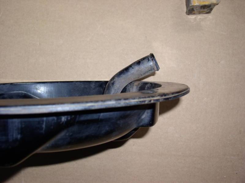

I am sorry if this is a dumb question but are the 65 Corvette 396, 69 Camaro 396 open element or with cowl induction use the same black air cleaner lid? I have a friend that is looking for one and was asked this but I did know for sure. Thanks in advance.
