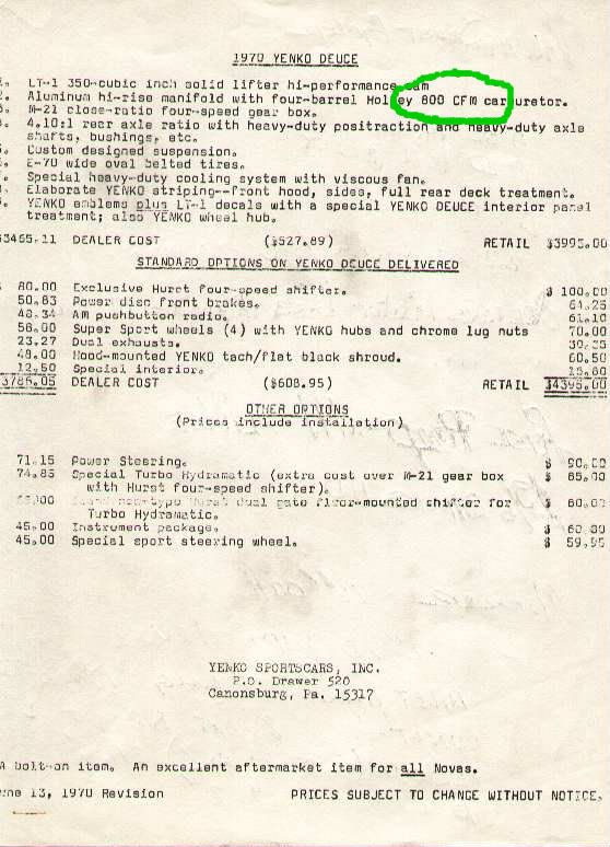

<span style="font-size: 17pt"><span style="color: #33CC00"><span style="font-weight: bold">Don Yenko listed them as &quot;800 CFM&quot; for the Deuces</span> ...</span></span>
