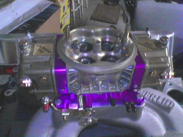

<span style="font-weight: bold">This was the motor, just after completely stripped, vatted, and in process of rebuild. 427 4 bolt main 69 Vette motor, Merlin 345 heads,
294/595 Comp Cam, roller rockers, Eagle 20/20 internally balanced crank, gear drive, ALL ARP bolts-</span>
<span style="font-weight: bold">Merlin Intake, Proform 950 carb, Moroso fabricated valve covers-</span>
