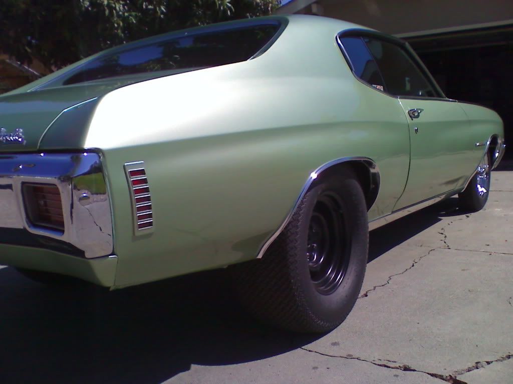

Here's my car with factory 15 X 8 Corvette Rallys and 28 X 11.5 M/T ET Streets.
I did a little research and it appears the 15 X 8 rally's have a 4" backspacing not 4-1/4". So a 4-1/2" backspace would be better as mine are a little too far out although I don't have an issue with any rubbing.
