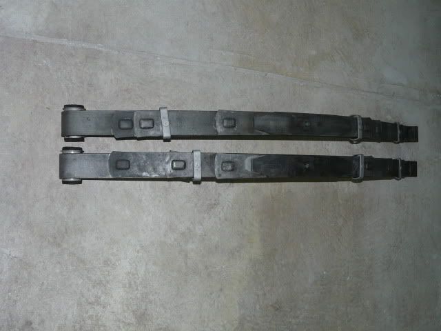

My car also has this funky set of rear leafs mounted to that rear the passenger leaf is forward.
