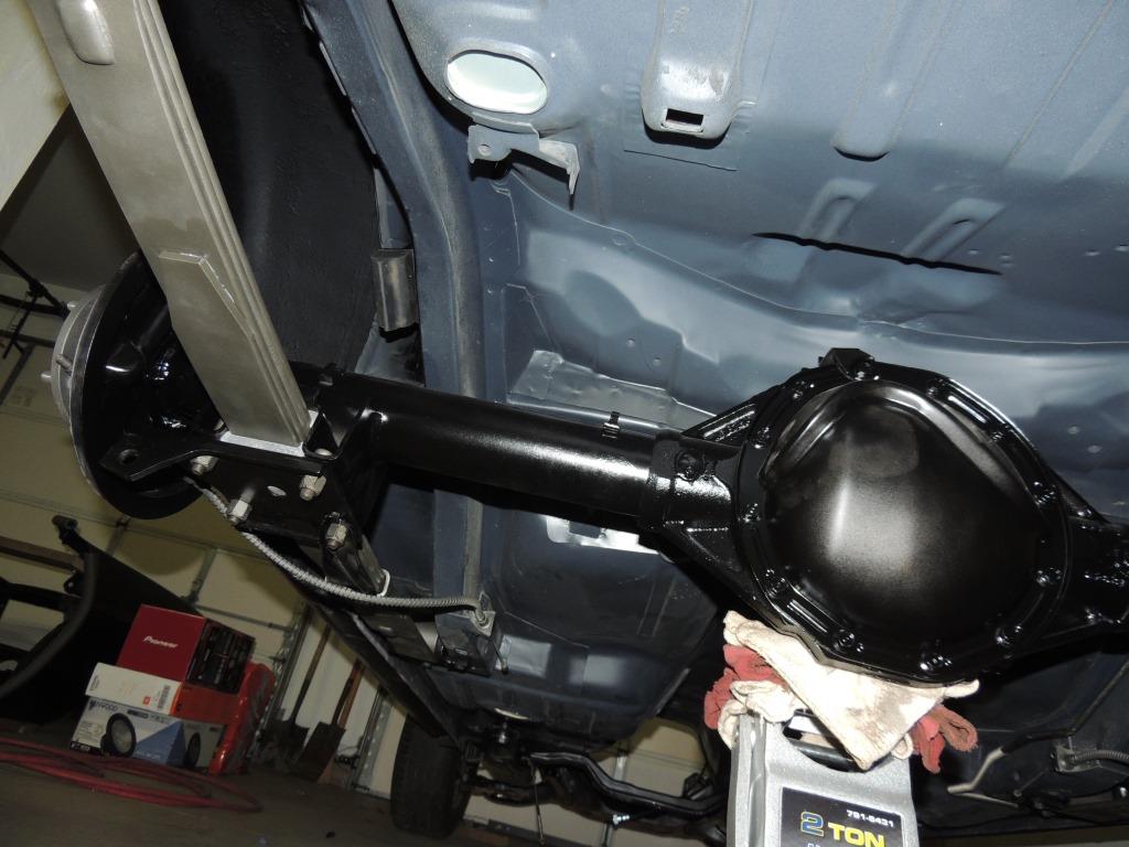

For what it is worth, other than the white overspray (my car is black) the above pics remind me of the underside of my car when I first cleaned it up. 08A.
Very dark primer sealer of some kind forward of the rear axle and much lighter primer from the axle back. Not sure why it was two different colors, but definitely was. Hard to tell how much overspray was on bottom, being a dark sealer and black car.
Again, for what it is worth, here is a pic of my car after the underside was restored. I replicated the factory look the best I could. I am certain the back was very light, as you can see, and forward of the axle much darker, but as you say, not black. I have heard conflicting stories of what was actually used at Norwood for the dark underside.

This looks like mine did, but slightly darker. What is the Build Date of your car? Mine was actually built March 31, 69. Thanks for sharing...
