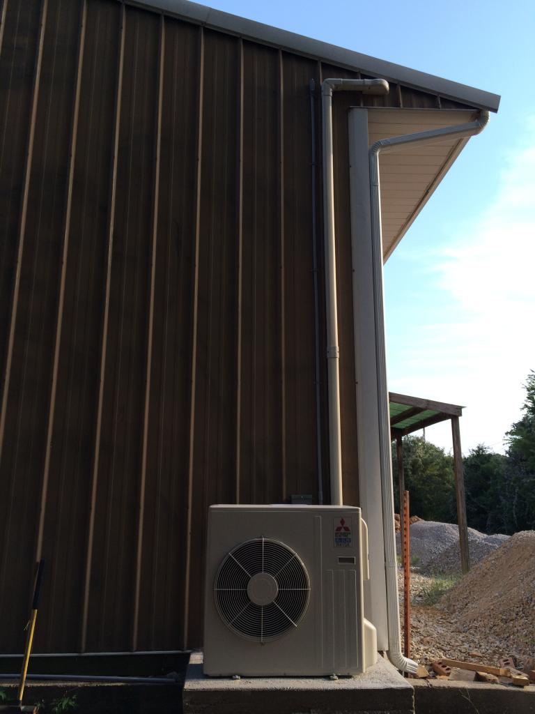

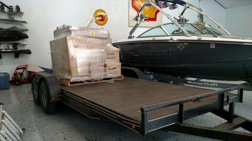

The Mitsubishi mini splits arrived on Friday. Now the fun of installation starts

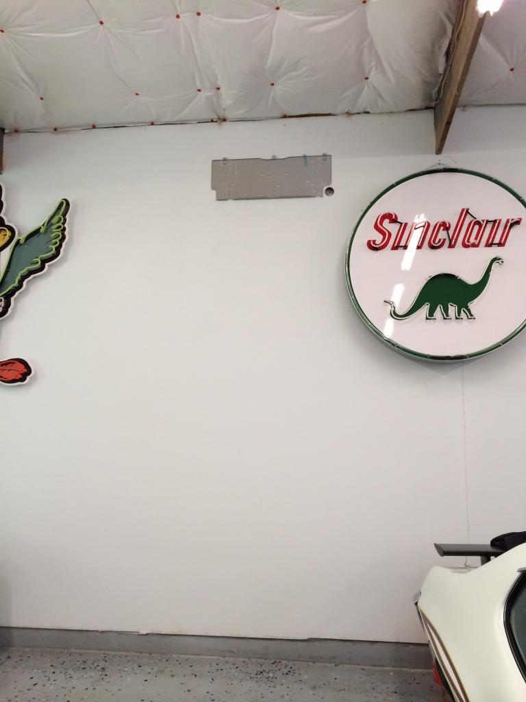

I was finally able to find some time to get my mini-split installation started. So far it is fairly straight forward. I should be complete next weekend and have the AC Company scheduled to perform the final connections and start the systems up.

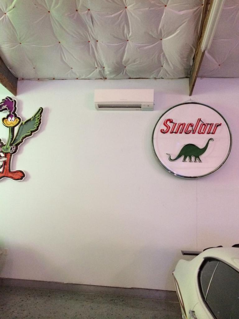

Completed the installation yesterday and started the units up. It was 100 degrees yesterday and my shop cooled to 70 degrees quickly. I am amazed at how much air volume these wall units can move.

I purchased the system from eComfort. The cost was $7,100 which included everything needed for the installation, air handlers, condensers, lines sets, and line hide system. The installation was straight forward and not that difficult. I ran the electrical, placed the concrete pads for the condensers, installed the air handles, ran the copper lines and installed the line hide. I paid a licensed dealer/installer to make the final copper connections, vacuum test the lines, purge the lines with nitrogen and then start them up.
