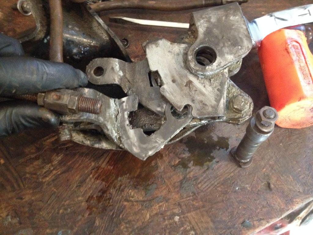

What type of grease was used when these were assembled. Its silver in color and has what looks like graphite in it as well..
Could it be this?

the originals I have seen had a white grease that has a cream color to it

Dont worry Sam Im not putting it back in the green car.. Just wanted to tear down, clean, reassemble &amp; preserve. [img]<<GRAEMLIN_URL>>/grin.gif[/img]
<div class="ubbcode-block"><div class="ubbcode-header">Originally Posted By: JoeC</div><div class="ubbcode-body">the originals I have seen had a white grease that has a cream color to it </div></div>
Joe, it could be white; lighting was not the greatest and plus there was a lot of grim on the shifter body. What have you used in the past? This stuff definitely has some type of graphite in it because it would smear and was hard to remove.. Could have been something my father added to help aid the shifting problem.. [img]<<GRAEMLIN_URL>>/hmmm.gif[/img] Obviously didnt work since he installed a Hurst.
Exactly.

same thing ive seen...with age it turns yellow and gets like concrete

Probably Lubriplate.......

The White Lubriplate is best because it stays put.
Never seize is only for non moving parts.

<div class="ubbcode-block"><div class="ubbcode-header">Originally Posted By: marxjunk</div><div class="ubbcode-body">with age it turns yellow and gets like concrete </div></div>
Exactly, as I found out with the NOS Muncie shifter body that I bought and installed in my car! Had to pull it back out and hose a ton of fresh white grease in there, and now it works great.
