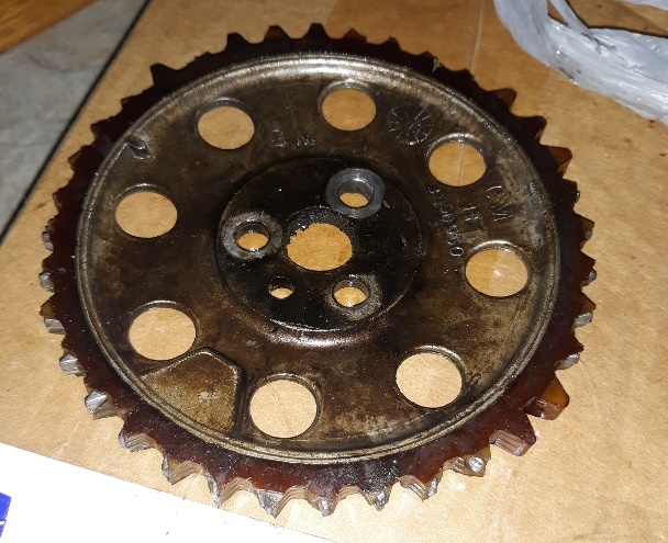

After being told a few months ago on the NCRS forums that I was living on borrowed time - I relegated myself to change it -
Good thing I heeded their advice.

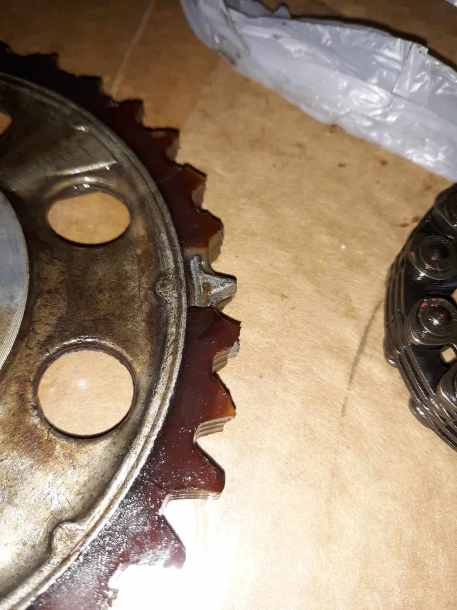

46k miles - only 19k miles since 1973 - check out this shredded nylon cam gear.
I picked up NOS pan gaskets and NOS timing chain cover gaskets plus a new balancer seal - National Seal which was the same number on the seal I knocked out. -

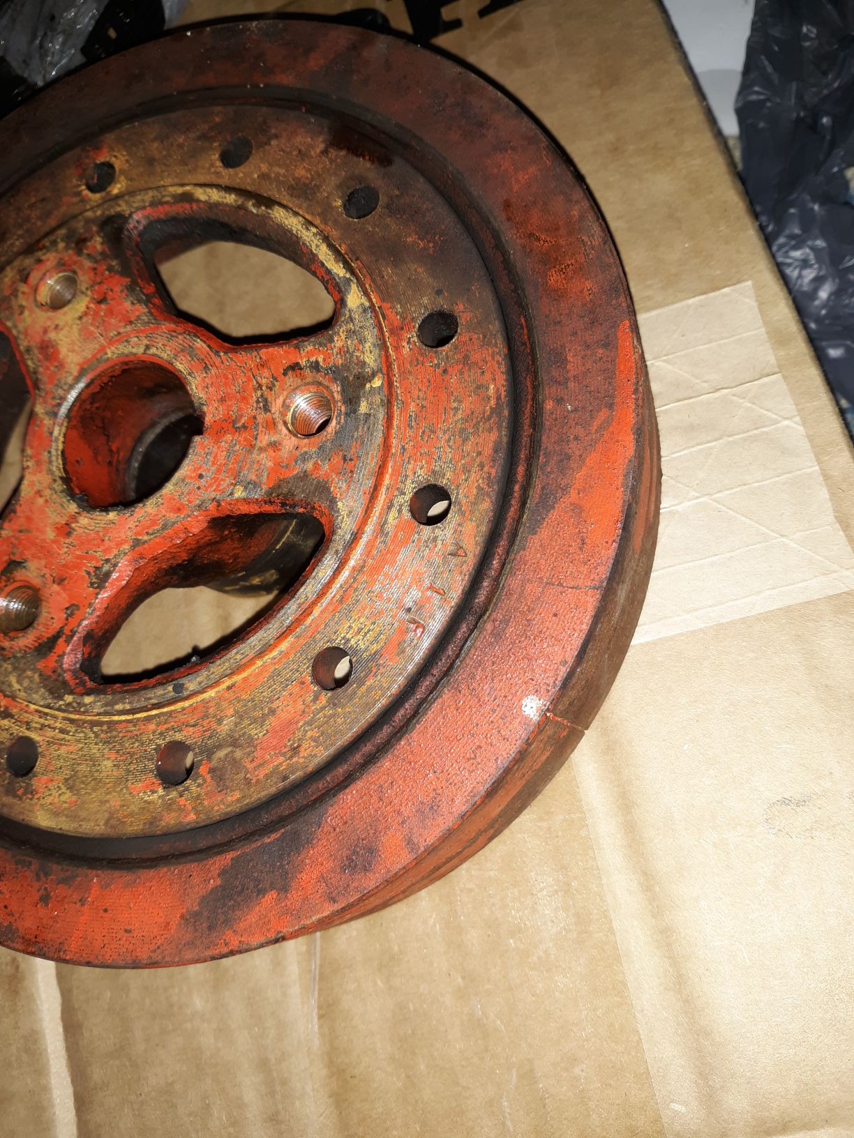

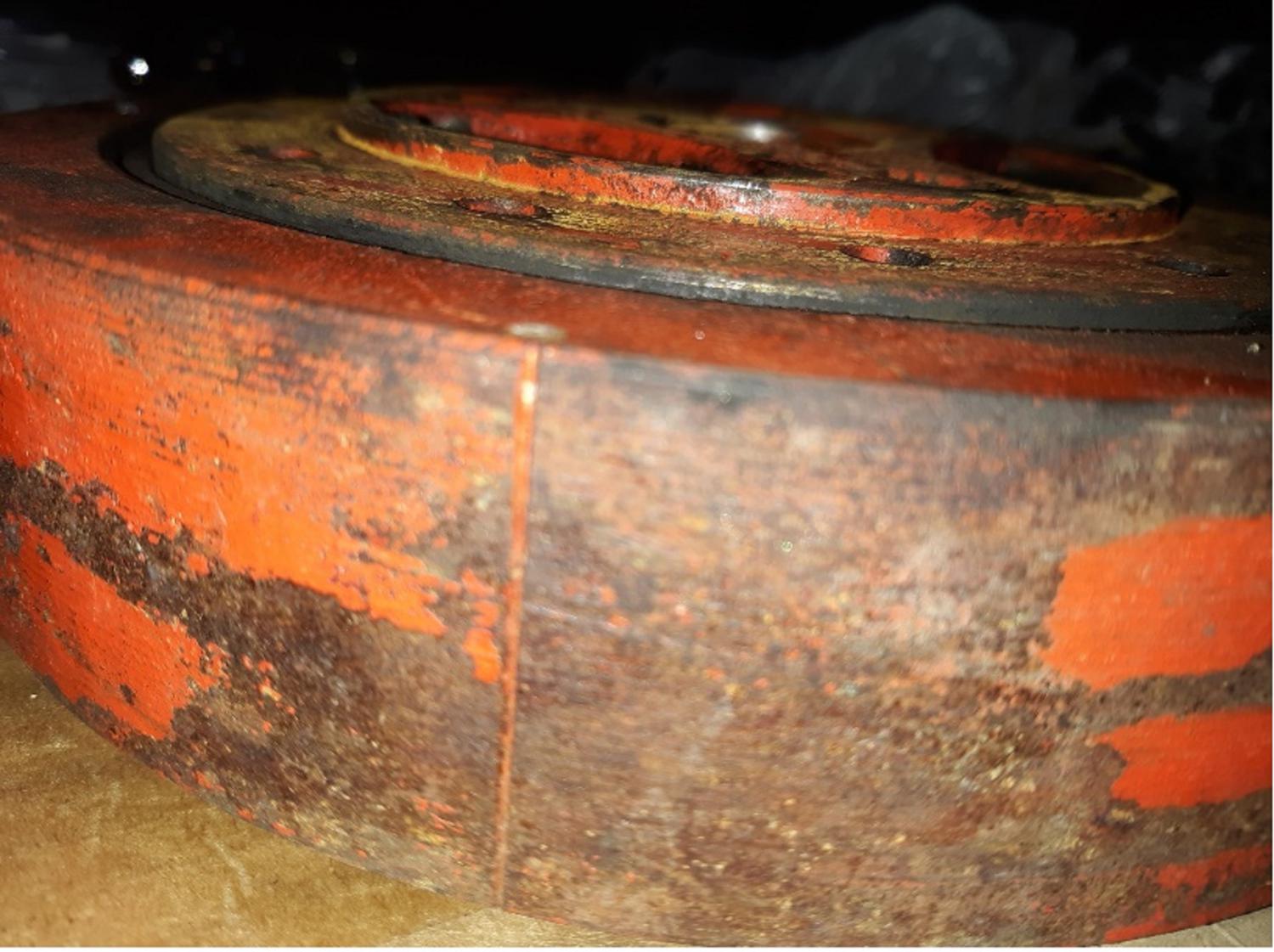

My original 7712 balancer has no groove, but the mass ring has spun on the center and shifted laterally to the rear by 1/8- 3/16" - so off for a rebuild at DamperDoctor.

Glad you got that fixed! Can’t tell you how many teeth I have cleaned out of pans and pickups over time. BTW, not that too many would replace with the same type sprocket (actually, no one I know), but I have a few of these sprockets with bright shiny white teeth that are new or like new if anyone is a diehard, hardcore, “has got to be like it rolled out the door” fanatic that wants one.

Cloyes Double roller going back in!
These engines have become too valuable to do anything else....Joe
