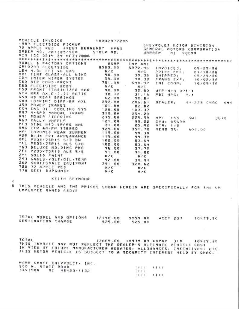

I would like to know how you document or determine that a car was a "Brass Hat" car. I have a Judge convertible that I think could have been one. The car has 38 options listed on the PHS.
I'm thinking about selling the car and I think that might help the value.
Any help would be appreciated

aren't the brass hat cars typically early production or built for promo for a special event? (ie. indy 500)

brass hat isnt usually a festival type car..its built for someone special, like a celebrity, or a zone managers demonstrator...in other words its usually a special car for a special person, usually the build sheets if found are pink for 69 up, cars and the early sheets have written instructions that spell it out.
the Burt Reynolds bandit T/A that was given to him by GM, has a pink sheet and has been posted publicly...the connection of a brass hat car can be made there easily..special car for a special person
Mark

An invoice that indicates an interesting dealer (like Royal or Knapfel) would be a plus, as would a dealer zone of PMD, Pontiac Engineering or PMD racing (07-621, 35-997, or 99-998, respectively). If the build sheet indicates a &quot;tag&quot; to a recognizable name, like &quot;TAG-WANGERS&quot; then that would be pretty conclusive.
Otherwise a lot of options does not a &quot;Brass Hat&quot; car make.
Additional commentary on &quot;loaded Judges&quot;:
http://forums.maxperformanceinc.com/...ight=brass+hat
