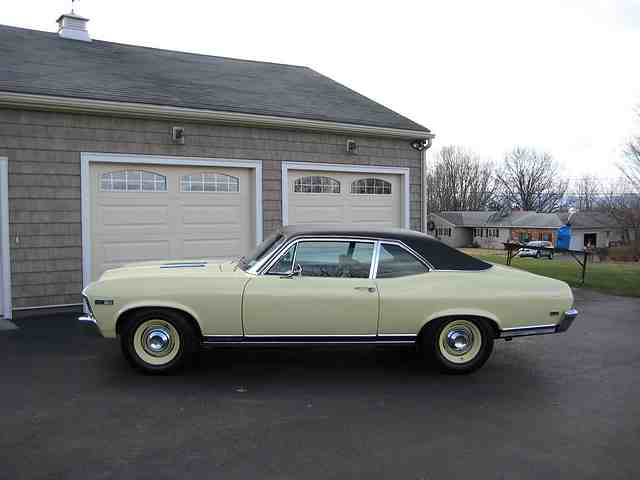

Here ia a 1969 photo...

Here is a 1968...

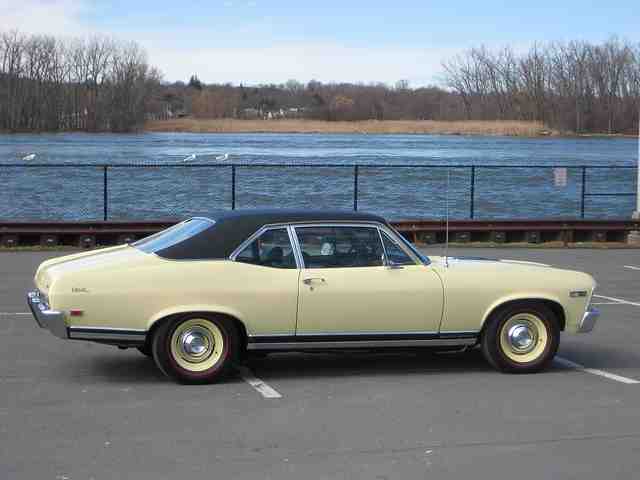

Another of the 1968..

The color does wrap around inside the sill...contact Wayne at NNN for the pics or what issue it was in...you may have the magazine already...you are a member, yes
I can take some close ups for you if you need them...let me know. SMS probably has the fabric...any good shop can do the seats. As for door panels...I know you can get black std....they could always be dyed, I guess.
