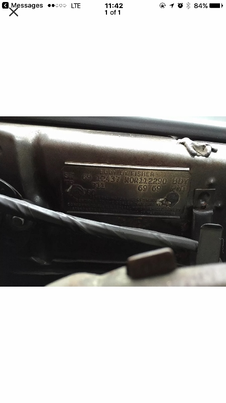

Pretty hard to believe but I suppose it's worth looking into.
I wonder what happened to the speaker grille on the top of the dash. Pretty ugly hole there, maybe a mechanical tach?
1969 Z/28 4,000 Miles

October 1968 car with a special ducted hood?

And a black grill. Why no dust flaps on inner fenders. Old drag car ?

Looks like an interesting car. Ad doesn't say much! Or is the text in white?! You might be right about a mechanical tach running through the dash. There is some duct tape just above the heater box which looks like it's covering a hole through the firewall. I'd like to see more pictures.

Some paint appears to be non original too, different tones between RF and pass' door?

Certainly the hood, grill and exhaust were changed. I like a lot of what I see under the hood. Yes the fender dust flaps have been removed, brake line repaired, repop tires, alternator & some clamps replaced, windshield squirted missing etc....but it has the type of patina you'd expect. It's certainly has had some things changed for a 4K mile car.
Interesting it was sold 10 months after it was delivered.

Alternator has been replaced.

As vague as it's described, there's surely some info that tells the real story of the car and why it was parked? States a factory 302 but nothing said about anything else makes me think it's a transplant perhaps. Maybe it sat with a blown motor since then.
The car is a factory DZ 302 with 4K original miles. The car has been parked and unregistered since 1969. The car starts runs and drives as it should. I have all the original documents for the vehicle

Cowl hood parts missing? Splice in brake line.
