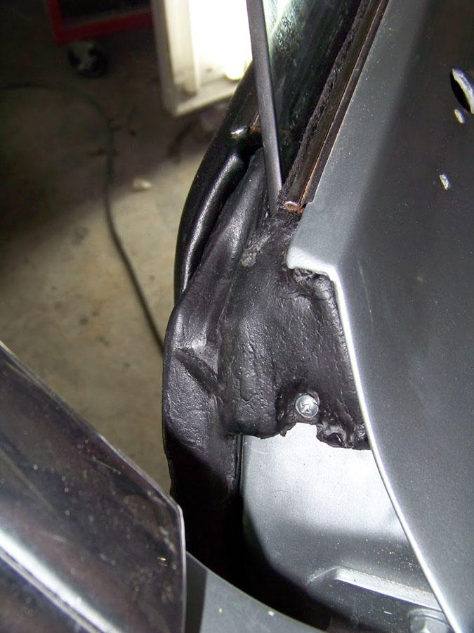

Yes and if the ends are cracked or splitting I redip the ends in black latex and then cure them out in a low temp oven, then spray with a little mold release after cured...
Attached is a photo of an Original assembly line weatherstrip end which I redipped and cured.

Liquid latex (available at Michaels or Hobby Lobby as a mold maker) mixed with carbon black pigment... I mixed a quart of it a few years ago and still have more than half of it after restoring 6 or 8 different weatherstrips.
The ratio of carbon black to latex was close to 15-20%.
I have been told that black latex is available premixed...
Here is a photo of the side of weatherstrip which was in much worse shape prior to dipping...
