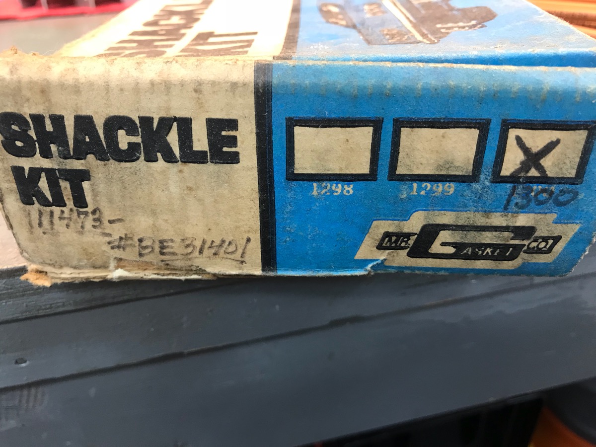

Old 05-08-2018, 05:59 PM
mockingbird812's Avatar
Location: Dayton
Posts: 14,403
Thanks: 908
Bentley - I have a set. Let me dust 'em off and see what I gots!
Sam...
bbbentley (05-08-2018)

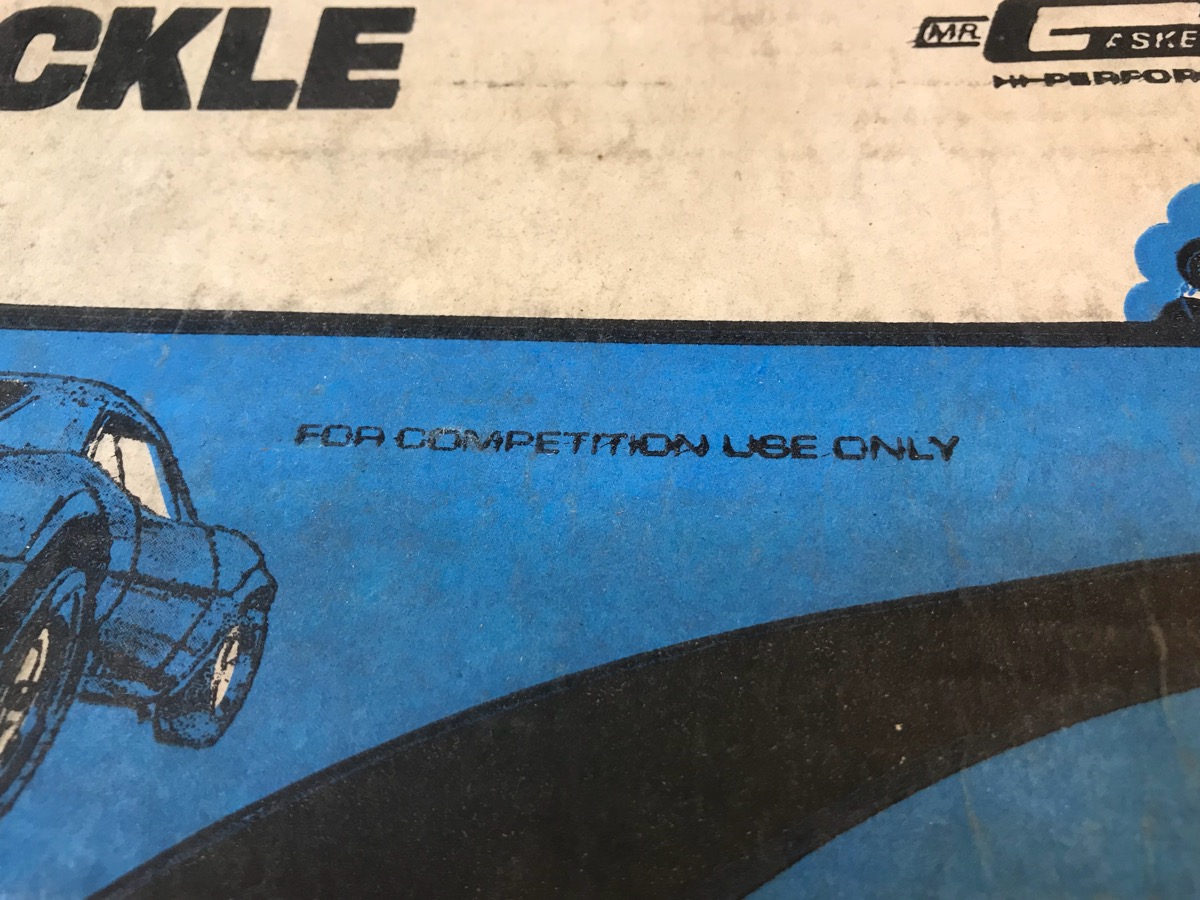

Old 05-08-2018, 09:28 PM
Location: Dayton
Posts: 14,403
Thanks: 908
Bentley,
Let me know if these will work for you…
Sam...

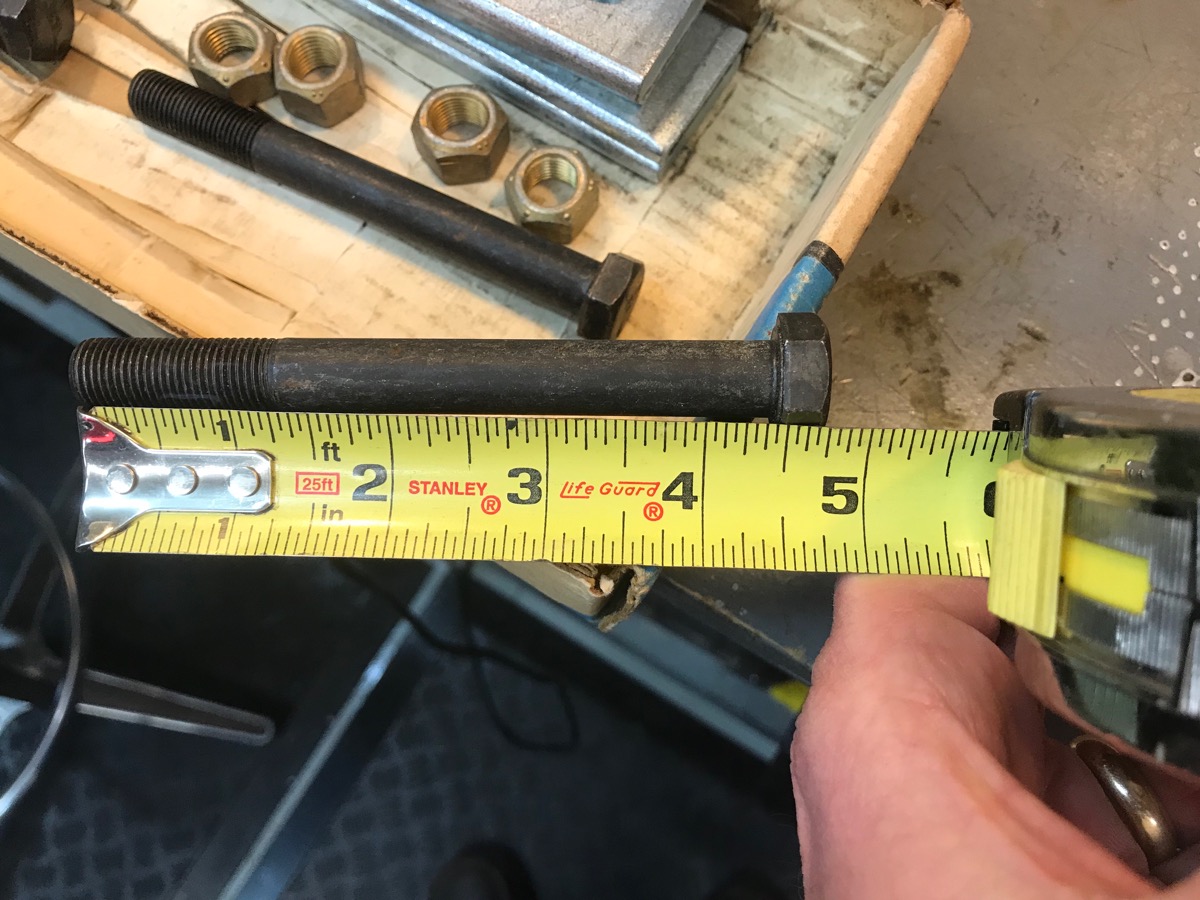

Old 05-08-2018, 09:31 PM
Location: Dayton
Posts: 14,403
Thanks: 908
More info.....
Sam...
Old 05-08-2018, 09:45 PM
bbbentley's Avatar
Join Date: Jul 2012
Posts: 2,263
Thanks: 452
Dang!!!! Id like those just to display. Of course those would fit what I need. Ill take em !! We will settle up. This site ROCKS!
