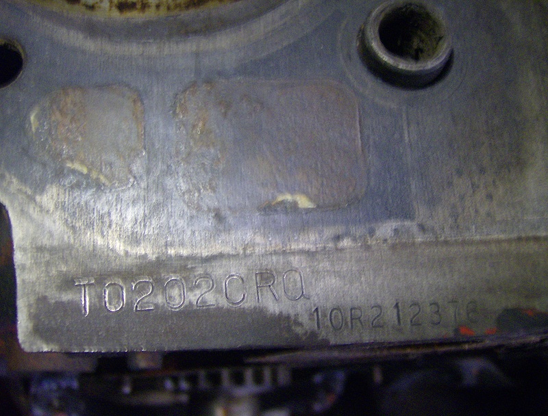

Another project with a scary paint job. What do you guys think about the deck stamp? Looks pretty dirty, which is good, but I don't have many Arlington partial VINs to compare this to.

Here is the deck stamp to mine . Does that stamp read CRT ? Is it me or does that trim tag look '' funny '' ?

It appears to have a LS5 engine out of another car. CRQ for LS5 automatic, CRT for LS5 4-speed.

each "3" has a different font...
