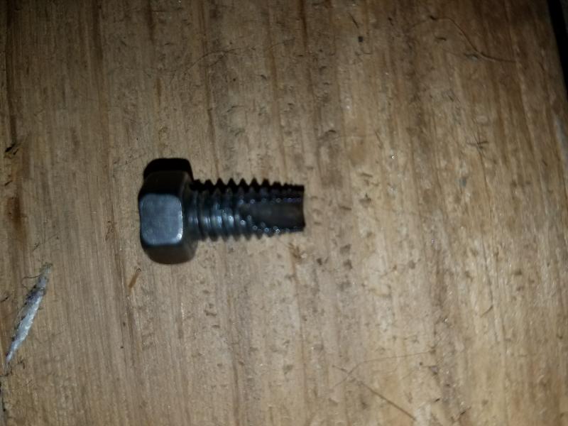

On a 69 s/b the clamp the holds the 2 heater hoses that bolts to the alternator bracket was the bolt a self taping or a nut & bolt that mounted the claamp to the bracket

self tapping

Does anyone have a picture of the correct type used

Just to be clear it is a 1/4 20 machine thread with a chisel tip. NOT a sheet metal screw.

I can get you a picture in the morning. There has been some discussion that some cars did not get a clamp. If your bracket is original does it have threads visible.

Heres the head and the notch out of the side

Great re; photo Bill, I might hijack that one
And on a side note I have seen a few survivor's without the clamp, along with no threads in he hole.

I think skips orange z had a tie on it. I'm not sure if it was random or period they did not use one.
