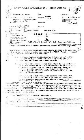

When was the first L-78 67 Camaro first introduced? Spring or fall of 1967

The #1 Indy pace car was the first car with a factory installed l78 Camaro, however it was replaced with an L34 prior to race duties. Grumpy Jenkins 67 L78 was the first available for sale. I believe they were built mid March 67.

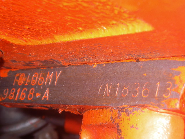

I think Steve is right for once. They also spec'd 307 gears but changed to 331's as they wanted more power out of the turns I believe. The rear end had the work order # and gear ratio stamped in it and then they restamped the ratio. I have pics here somewhere.

Old 11-04-2018, 12:58 AM
Location: Woodland, ca. US
Posts: 15,982
Thanks: 497
Old 11-04-2018, 01:00 AM
Posts: 15,982
Thanks: 497
can't find one readable
