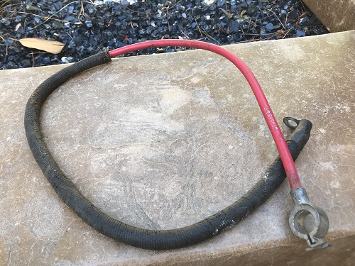

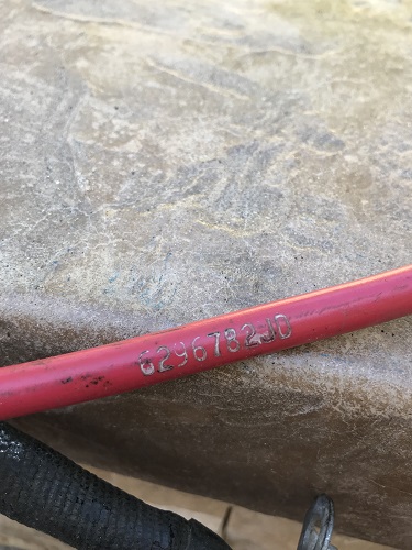

Anybody recognize this NOS Positive Battery Cable? Part number does not come up in line.
Part # 6296782JD
Thanks for your help.
Part # 6296782JD
This is for a 1969 Buick Skylark. It fits models 434-436-442-444. This info is right out of the Delphi Packard database. It is not for a 70 Pontiac as they used a black cable for the positive. 95% of the time, the only divisions that used red cable for a positive were Olds and Buick.
When you say 1969 Buick Skylark models 434-436-442-444, what does models mean? Also, is this also same as 1969 Olds?
Could you possibly post or send me a picture of the part number reference page?
No, it is strictly for the models I listed, not Olds. Sorry, but we cannot post the info you are requesting, it is proprietary. If you have a specific number you need an answer on, I will always try and tell you what it is. The info you're asking about is thousands and thousands of pages. As far as the Buick models, it is an educated guess that they are the Special and Skylark models.
