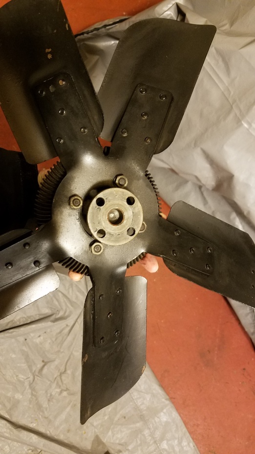

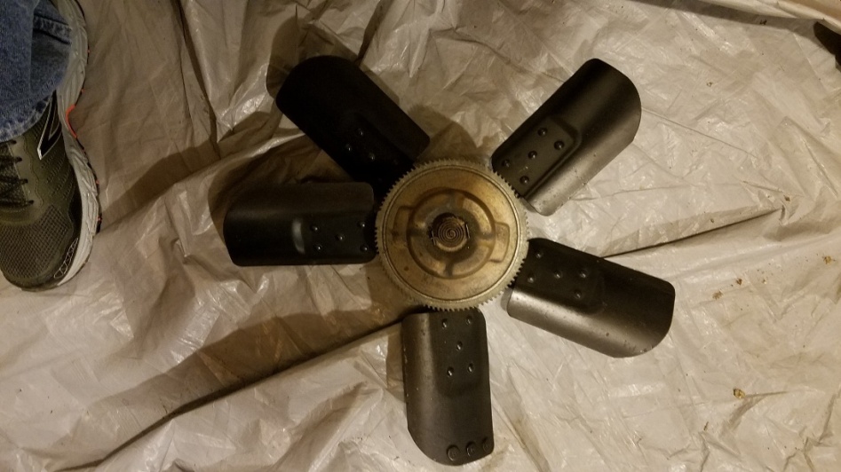

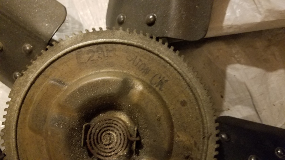

I just want to share some information regarding two 7B 67 L78 Camaros. Conventional wisdom has it that L78's received only the schwitzer clutch and fan 3871276 with large diameter mount. My car came with the 912239 fan (note 5 rivet per blade) dated F7 (June 67) and Eaton clutch date E29 H (May 29th 1967). I know of another survivor built same week configured identical. If anyone else has any example please post car build date and specifics. Thanks!

The balance weights on the blade are interesting. I've never seen this on a OEM fan (I'm sure it's probably factory, I've just never seen it).
