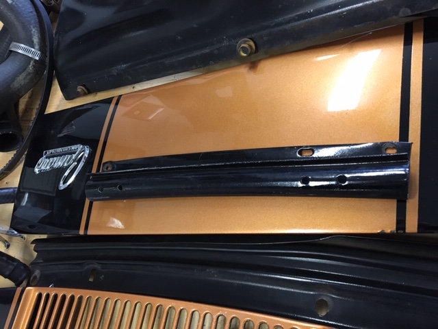

This one was mixed in with my 67-69 Camaro stuff. About 12 inches long, as opposed to the Camaro's 13 inches. Also two holes that look like factory versions for mounting something, anyone know what car this piece goes to?
Thanks

That looks like the 70 and up version to mount the TCS relay. Don't toss it, those are needed by a lot of people especially without broken corners and screw holes as the reproductions are not correct.

That wiring gutter was used on the late build '69 Camaro's. They did not use the TCS but had the provision for it.

Warren, why would it have been shorter for the later build 69's?

I guess you would have to measure a '70 Nova wire gutter and see if it is that size, or get someone on this site that has a late build '69 Camaro and see if it matches.
Between Rick and I, we gave you a starting point.

My 08E 69, 1969 Camaro has the old style...Joe

Here's my 09D (1969) wiring gutter. Can't promise it's original....it has two sets of holes on the engine side and is 13" long.

I have three 13" long originals as well.
The one on my '70 Chevelle is 13" long,as is a local friends original unrestored chevelle.
