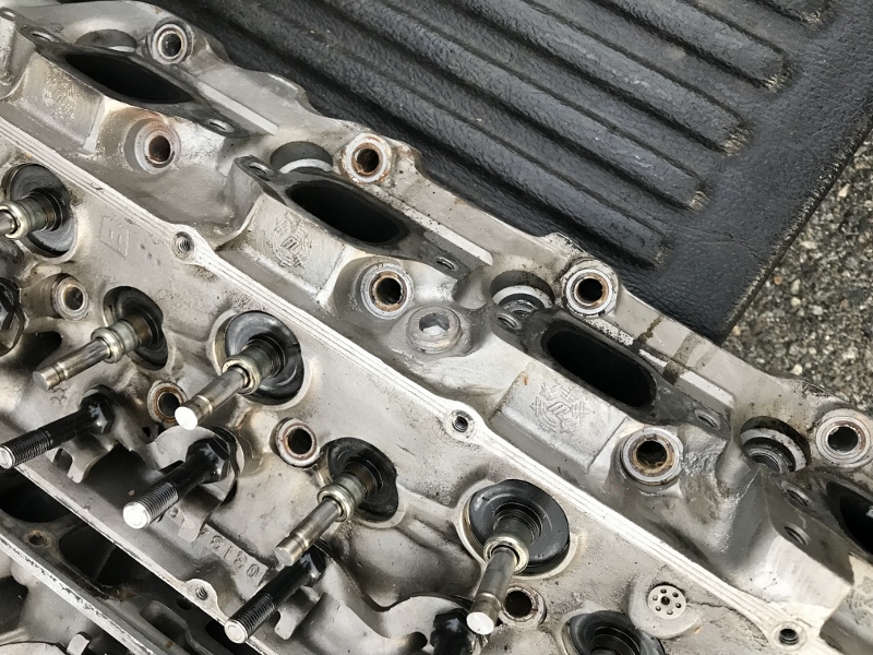

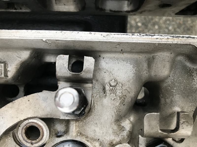

Thanks for the discussion everyone, I'm really not sure what I have here then.
I've got a pair of match dated 05-27-68 square port aluminum heads that I can't find any info on, even https://www.mortec.com/bbc.htm doesn't list the casting number.
(did they (GM) even make not-square port aluminum BBC heads?)
I assume they're GM as they have the snowflake...
But mine have a leading 0 casting number: 0313436 which is on a pronounced pad and each head has no less than five Winters snowflakes cast into it / them, one small one inside and a larger one over each exhaust port...
They recently came off a running Tri-Power Corvette and I was told there's about 5000 miles on them - they've likely been rebuilt before as they're stamped "L" and "R" & "OK" by the date. They have press in plugs.
Are these experimental pieces?
Thanks again everyone!

Default How many different casting numbers are there for aluminum BBC heads?
Anthony: The heads that you have are prototype (pre-production) heads. Any part numbers that start with a zero (0) or a zero dash (0-) are prototypes. I have a (0-xxxxxx) aluminum intake manifold with a winters snowflake emblem, as I am near the winter's foundry plant in Canton, OH. Don.
