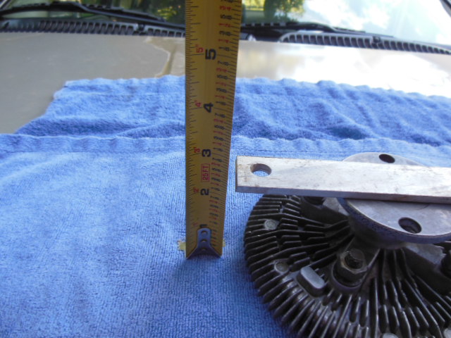

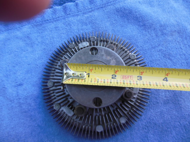

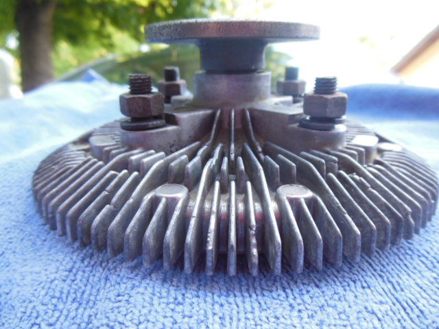

this is the fan clutch off my 69 big block with curved neck radiator was wanting to have it rebuilt but they are saying this is not the correct clutch was hoping someone could jump in and let me know if this unit is correct for my car

Who is telling you that?

Correct fan clutch. There should be a date stamp on side of hub.

Hard to read the date on the clutch i can see 68 sc the build date on the car was 12d also is the clutch the same for a/c and non a/c cars with the curved neck radiator

It had to do with HD cooling...Joe
I'd have to reference a manual but the A/C unit was dimensionally the same as the HP clutch. They changed the HP clutch due to high rpm application. I believe A/C later two digits 49 and HP 50.

sounds like this is correct for a non a/c car
Looks like my original. I think you have the right one. I have pics on the attached thread.
