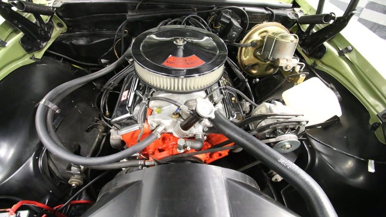

Sharp car, NOM, priced pretty steep considering. Not sure WTH happened to the RS lower belt line trim...yikes.
What do you guys think about the authenticity of the docs? Pics below.

Z/28 emblem on the grille? Nova Gauge Package...I would doubt this is a real RS based on the pics. The Vin and Trim tag were rusted Bigly....

There's lots wrong with this car. I wouldn't know where to start...Joe

Build integrity seems to be lacking.

Oh boy. "No expense spared"

They could've spent more time on research...Joe

How much rust did this car have if the vin plate is rusty?

That paperwork is about 35 years newer than the car...

First time I have seen the braces mounted on BOTH sides of the alternator boss.
That's the rare HI TORK alternator option! ;>))
