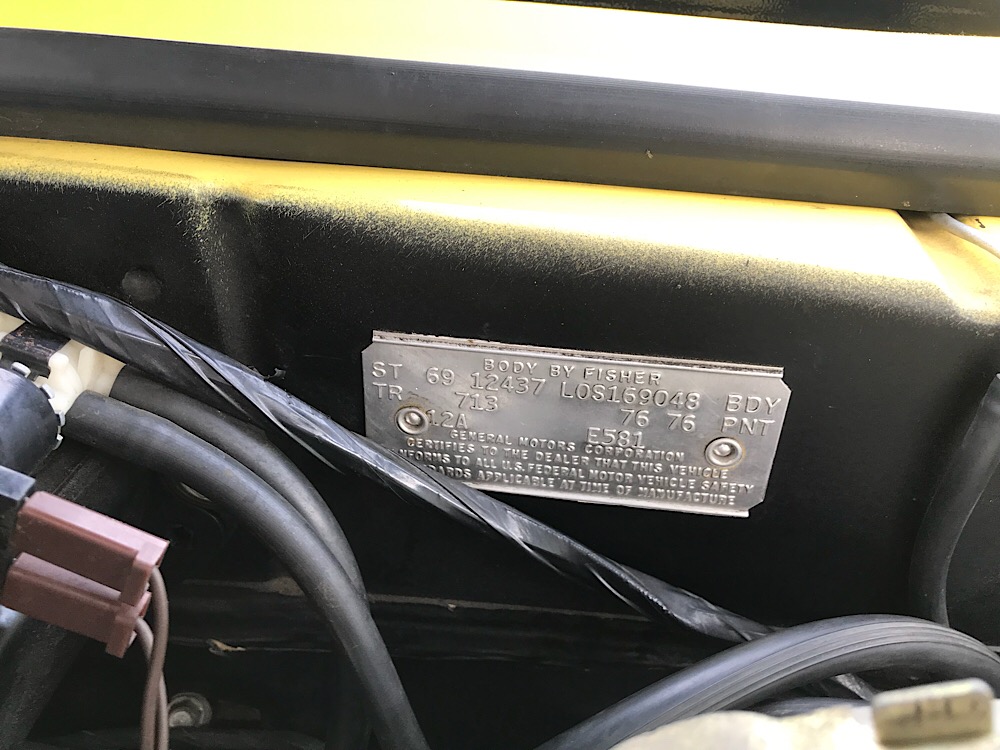

Nice car. I wonder why that headlight door isn't completely closed. Has the trim tag been off of the car?

Nom. Too early for a ducted hood and '69 rear spoiler.
Body tag rivets not original. Tag does not compare with other LOS tags.

I don’t like that trim tag at all not right IMOP

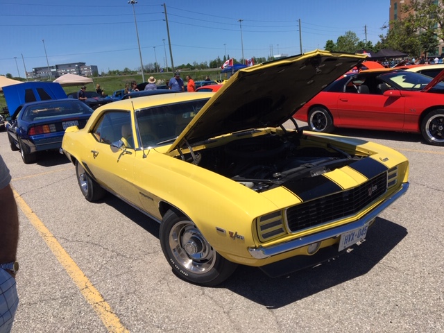

Reminds me of a car I saw this summer at a show here in Ontario. Yellow Houndstooth,
ZL2, RS all documented by GM of Canada. Originally billed to 'GM of Canada Show Car
Account'

I have an earlier pic of the original trim tag, same data but some corrosion on it. Must be why it was replaced.
