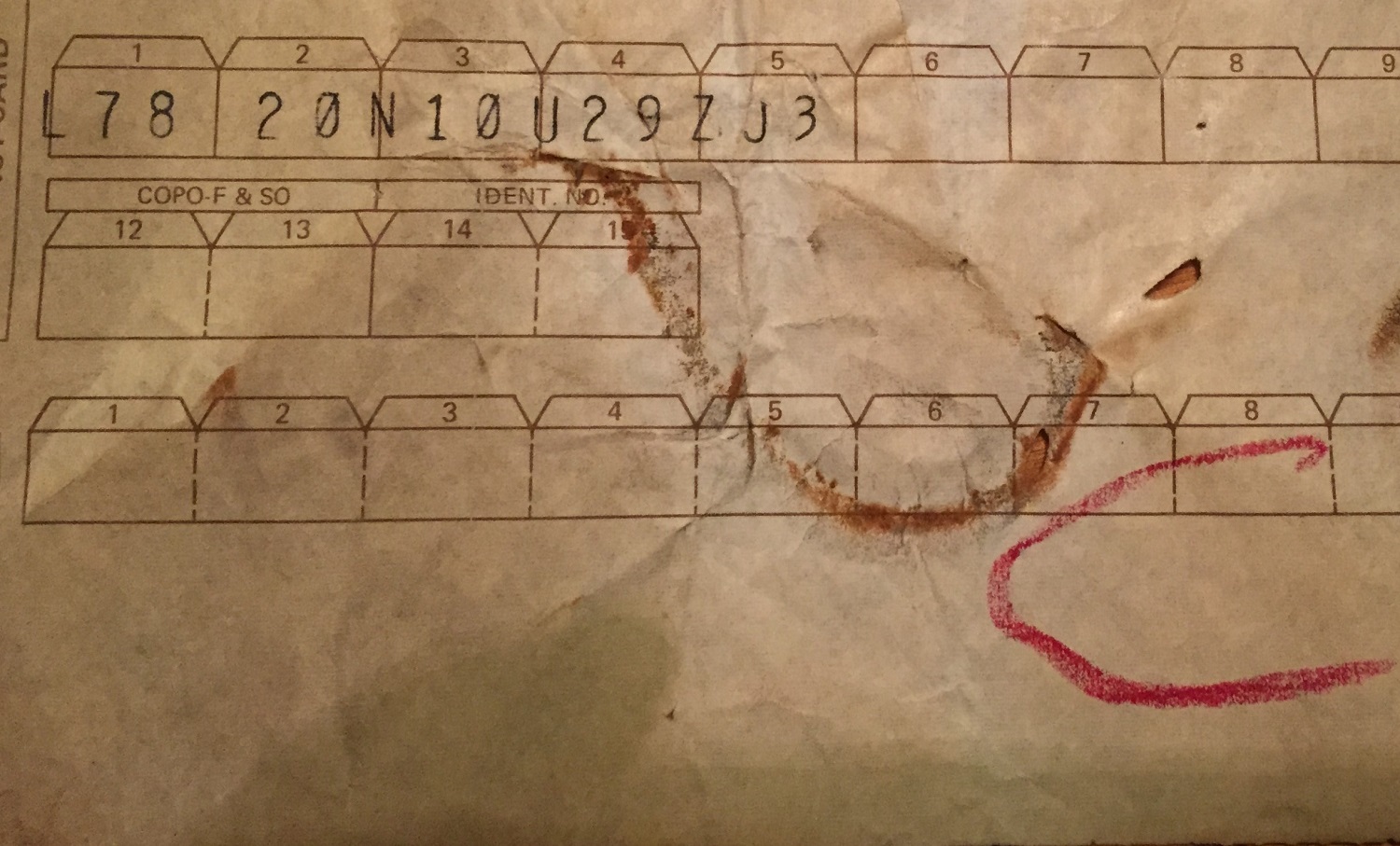

Hey All, I wasn't sure the right place to post this but I am in the middle of a restoration my 69 L78 Nova and while the car is out at Micky Hales shop getting the majority of the work done I'm prepping to do the interior, electric, brake and fuel lines once it comes home. As I was going through shelves full of parts I found a second build sheet under the back seat (first build sheet was under the front seat) but it was literally slipped over one of the metal rods and stapled through with the upholstery material. Between that and its brittle nature I got it out but in six pieces. Like I said I do have the other other build sheet but hoped to somehow piece this one back together to preserve it and wondered if anyone had any suggestions?

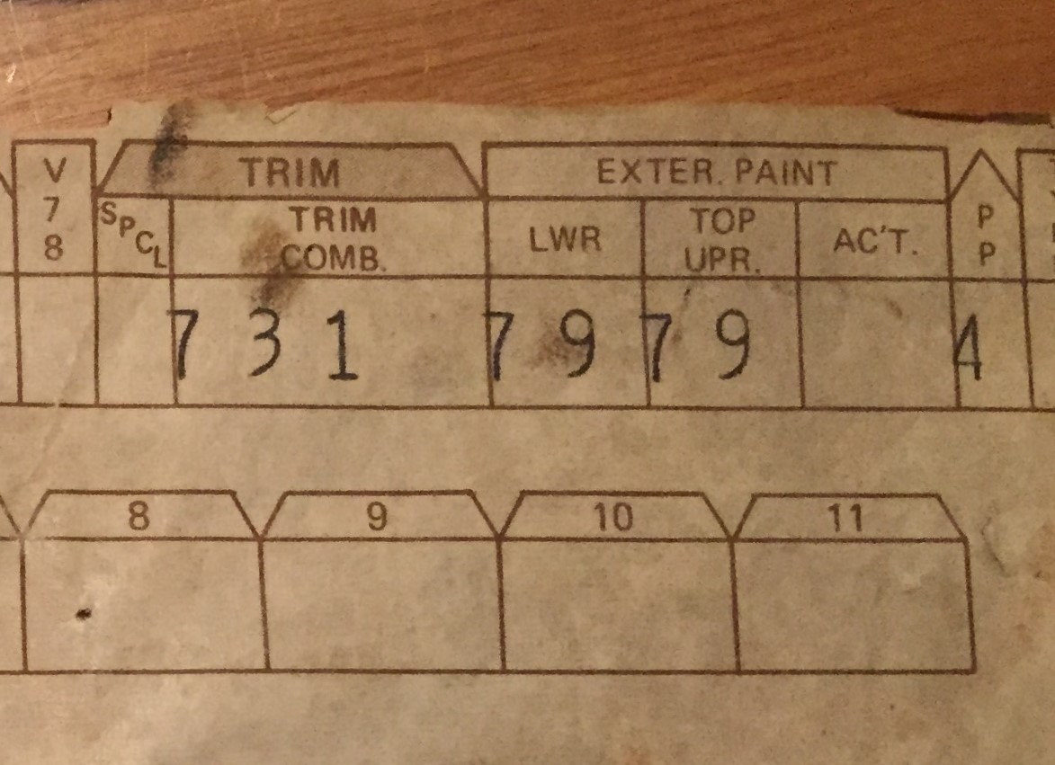

Follow up question...instead of starting another thread on my build sheet I thought I'd just continue this one. I decoded most of my build sheet but does anyone know what the 20 is after the L78 code in the first pic? And what does the 4 under the PP in the second pic represent?
Thanks in advance!

Pics are reversed obviously

Ed,
Box #2 was the trans code. Should read m20.
Looks like a typo with the letter missing

Hey Tony,
Thanks for the reply! It must have been a full typo as I have the original trans and its stamped P9S20B (with the VIN below it) which I believe is M21? Well at least I know what was supposed to be in that box

Originally Posted by Qtown Ed View Post
Hey Tony,
Ed
The buildsheet code 'M20'...does not indicate the specific transmission installed, eg; M20, M21 or M22...this code simply told the Fisher Body folks they needed to cut a hole in the floor for a manual trans. shifter. This is a very common point of confusion when folks look at the Fisher buildsheets. Basically the sheet indicated any work needed to the body to facilitate installing various options like; trim and moldings, floor shifters, consoles, decor packages, etc.
