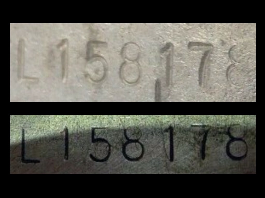

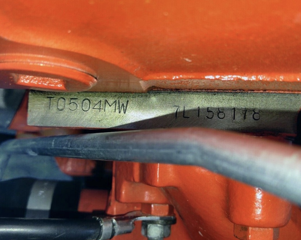

67 SS396 on eBay. Really nice car, but what do you guys think about this block stamping. Looks to have been decked?

Old 10-26-2019, 03:17 PM
HuggerSS HuggerSS is offline
Join Date: May 2017
Posts: 522
Thanks: 79
Thanked 939 Times in 194 Posts
I have seen a lot of BB stampings that are directly under or underneath the head plug. The all “claim” to be original stamps. I am not sure how this could have been done.

Thanks. My concern is more what appears to be circular machining marks. They are very light, but I swear I see them!

Old 10-26-2019, 05:03 PM
Tarrytown SS427s Tarrytown SS427s is offline
Join Date: Mar 2006
Location: Albany, NY
Posts: 529
Thanks: 8
Thanked 27 Times in 11 Posts
It looks like a restamp to me.

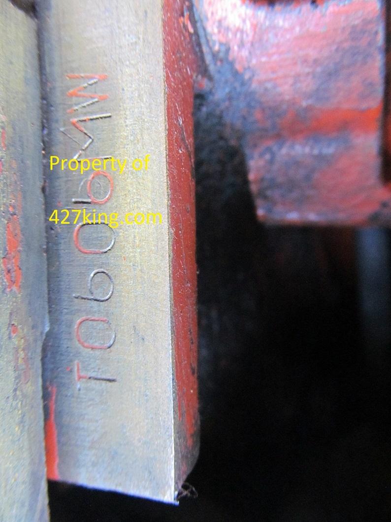

Old 10-27-2019, 03:09 AM
the427king's Avatar
Join Date: Jun 2011
Location: CT
Posts: 7,070
Thanks: 217
Tony heres the pad from the car you found me.

Old 10-27-2019, 03:13 AM
the427king's Avatar
Join Date: Jun 2011
Location: CT
Posts: 7,070
Thanks: 217
Notice how high the center of the W is pointed on mine vs the one at auction.... IMO it is a restamp.

Old 10-27-2019, 03:28 AM
Zedder's Avatar
Zedder Zedder is offline
Join Date: Sep 2002
Location: Ontario, Canada
Posts: 3,322
Thanks: 100
Thanked 638 Times in 351 Posts
Thanks! Yours looks much better! That pad is perfect!

Old 10-27-2019, 05:14 AM
169indy's Avatar
169indy 169indy is offline
Join Date: Oct 2001
Location: Washington
Posts: 784
Thanks: 1,103
Thanked 705 Times in 236 Posts
Tonawanda stamped the deck prior to the heads being installed.
"The engine suffix was stamped on the deck before the heads were mounted (at least for BB's....not sure about SB's), which would explain how some stamps can be so close to the heads that would otherwise make it impossible for a gang stamp to reach."
