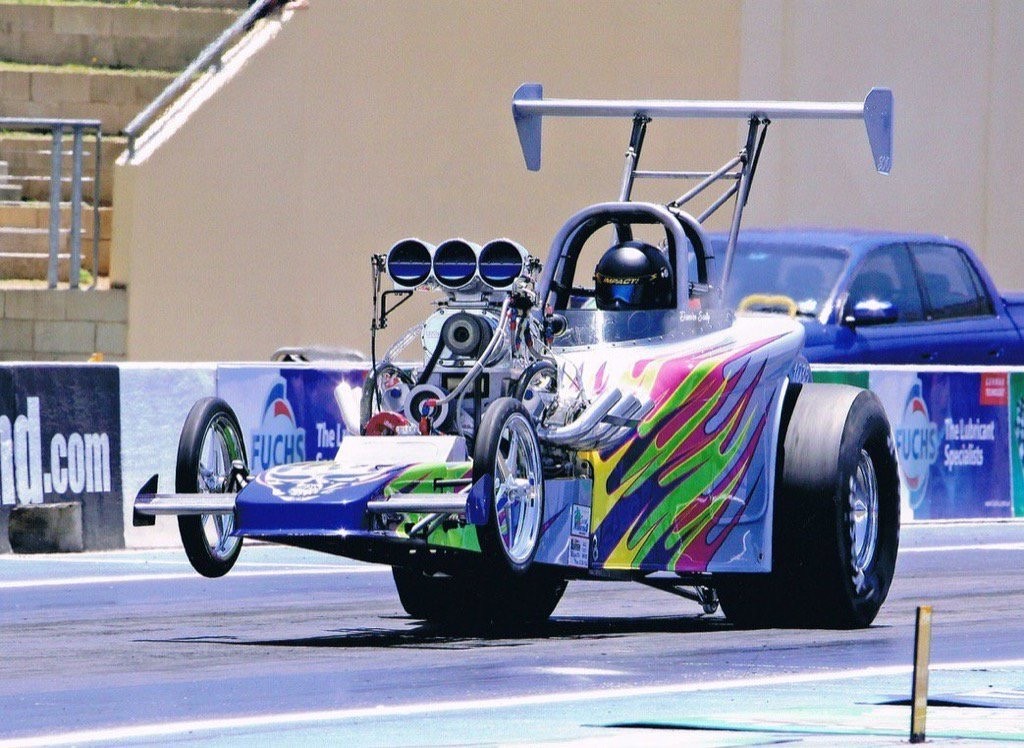

I had two different RCD front drive set ups on my race car and both of those were adjustable to some degree. I can get a better pic later for you if you would like.

Sweet! Thanks for that pic, Damien. Yes, I’d like to see a closer pic.

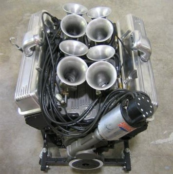

Here's the engine from my Scarab race car with the Summers Brothers set up. I'm certain it is fixed in this position. There is a big spacer for the water pump and the pump is electric. I've had no issues with this set up.
Damien (11-21-2019)

Here's a good shot of the spacer and water pump.
