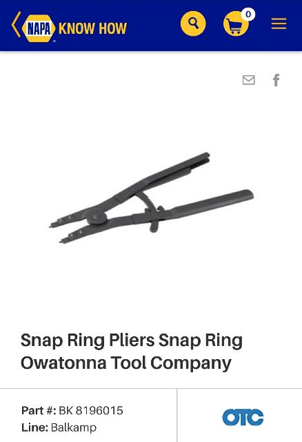

Looking for what you think the best pair of snap ring pliers are out there. Trying to get the middle bearing retainer snap ring off muncie 4 speeds. Its inevitable that builders install it backwards on the shaft making it almost impossible to remove. I have a good set of SK with offset tabs that work good if you can get straight on it. The problem being most of the time the speed-o gear is still on shaft blocking the removal of the reverse gear. Which causes you to have to be at an angle. The typical ones that you install tips on don't even touch it. Thanks in advance. Larry

I had to find a set today. One of our tractors has tracks instead of tires and 3 of the bogie wheels were leaking. Our pliers were not big enough and NAPA was the only place close that had a set. They are about a foot long. The snap ring was 4 inches and felt like that thing was ready to fly off and do some damage!! The pliers have teeth that catch and you dont have to keep pressure on them the whole time. Worked really well

Anyone ever used this pair.
https://www.ebay.com/itm/Retaining-R...nd!85704!US!-1

Those are similar to mine but the rachet on mine goes more straight across the handles. When you squeeze it, the next tooth catches and is a nice feature. Mine does have a lever along the handle to release the rachet. I tried to get a picture today but my phone wouldnt resize it for some reason. I will see if I can get something.
