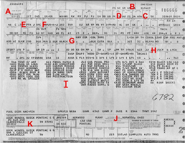

Rough car...I like how the seller states there is a "partial build sheet that I was given in a zip lock bag that shows the L78 option." No way is that a 1970 Chevelle build sheet...maybe a later model Firebird?
Was an original BB car for sure (partial VIN is on the TH400 trans) but was originally Gobi Beige on Saddle.
