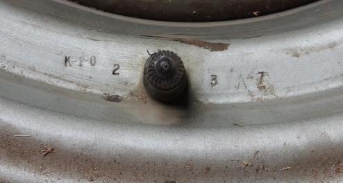

What is the date stamped on the rim by the valve stem

Default Wheel Date
Looks like Feb 3 of 70; 8 days before the body build date.
Also noticed the lillte spot weld (although this one looks like the mig gas was low) as seen on many YH wheels.
