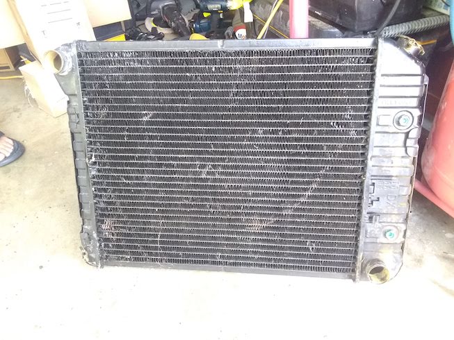

Core measured 21" wide. Hopefully you all can help me decode this I have no idea.
Thanks!

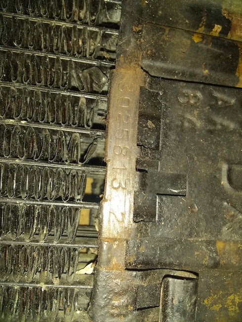

I have a guess, but first what is the number on the bottom edge of the tag? 3025813?
Kurt,
Yes. "3025813 2" I also noticed AA on that tank. Pics attached. Thanks!
Jose
Jose Betancourt
67 Camaro L78
Old 06-17-2020, 05:45 AM
Kurt S Kurt S is offline
Location: Ann Arbor, MI
Posts: 3,092
Thanked 787 Times in 366 Posts
Thanks for confirming the number. I wasn't sure on it. I can't find anything on the number, but it's a mid-70's Chevy. Pretty sure Nova.

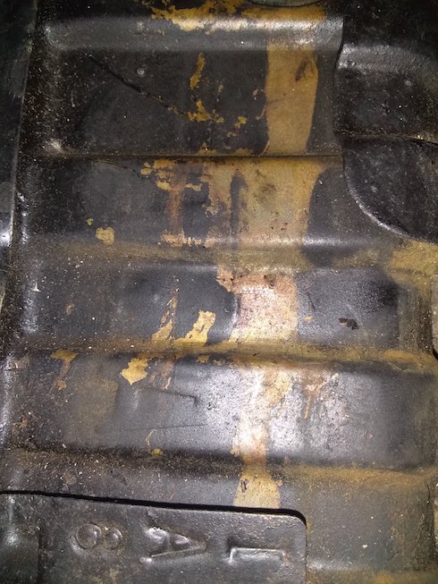

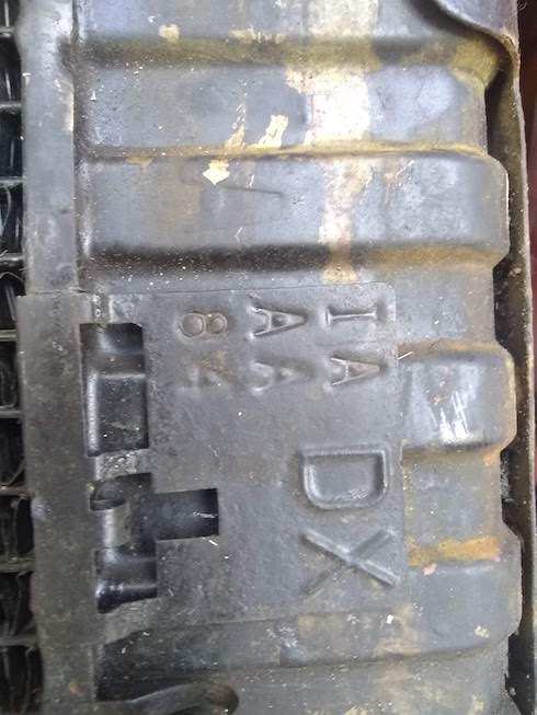

Old 06-18-2020, 02:20 AM
firstgenaddict's Avatar
Posts: 5,596
Thanks: 161
L1 in the depression between the AA is the date code - December 1971.

Old 06-19-2020, 04:17 AM
jbtech's Avatar
jbtech jbtech is offline
Join Date: Apr 2020
Location: CA
Posts: 557
Thanks: 568
Thanked 1,531 Times in 263 Posts

Old 06-19-2020, 04:39 AM
jbtech's Avatar
Join Date: Apr 2020
Location: CA
Posts: 557
Thanks: 568
It could be from a '72 Nova 250,307,350. That part number does check out. Hmm... I'm going to let this radiator go but want to advertise it correctly.
