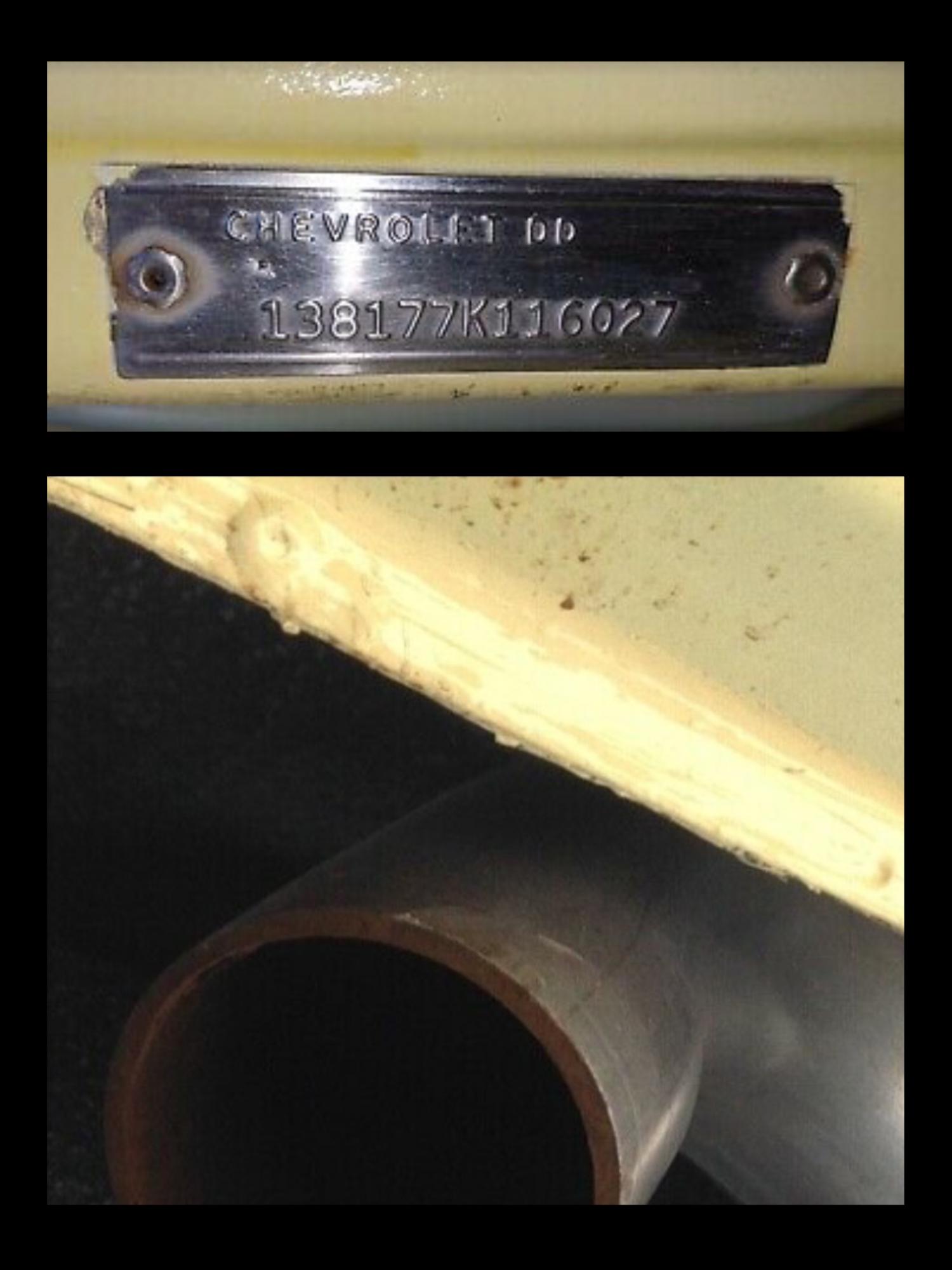

Well this car has a new owner and it's on the block yet again. This time it comes with what the seller is calling the 'original transmission' in the trunk - which looks suspiciously like a Saginaw. In any case, this car still intrigues me, but as was said earlier, this one needs to be looked at closely for rust as it grew up in the Chicago area.

That 3788421 bell housing is '63 model year only 153 tooth flywheel, and yes, that trans looks to be an iron Saginaw 3 speed.
Looking at the pic of the RH quarter behind the tire, near the top, is that a painted over pop rivet through the pinch weld??

At least the correct VIN 138177K116027 is posted this time w/ fourth last digit 6, not 3.
Good info on the bellhsg/trans also yep, sure looks like a painted rivet or pan head screw.
