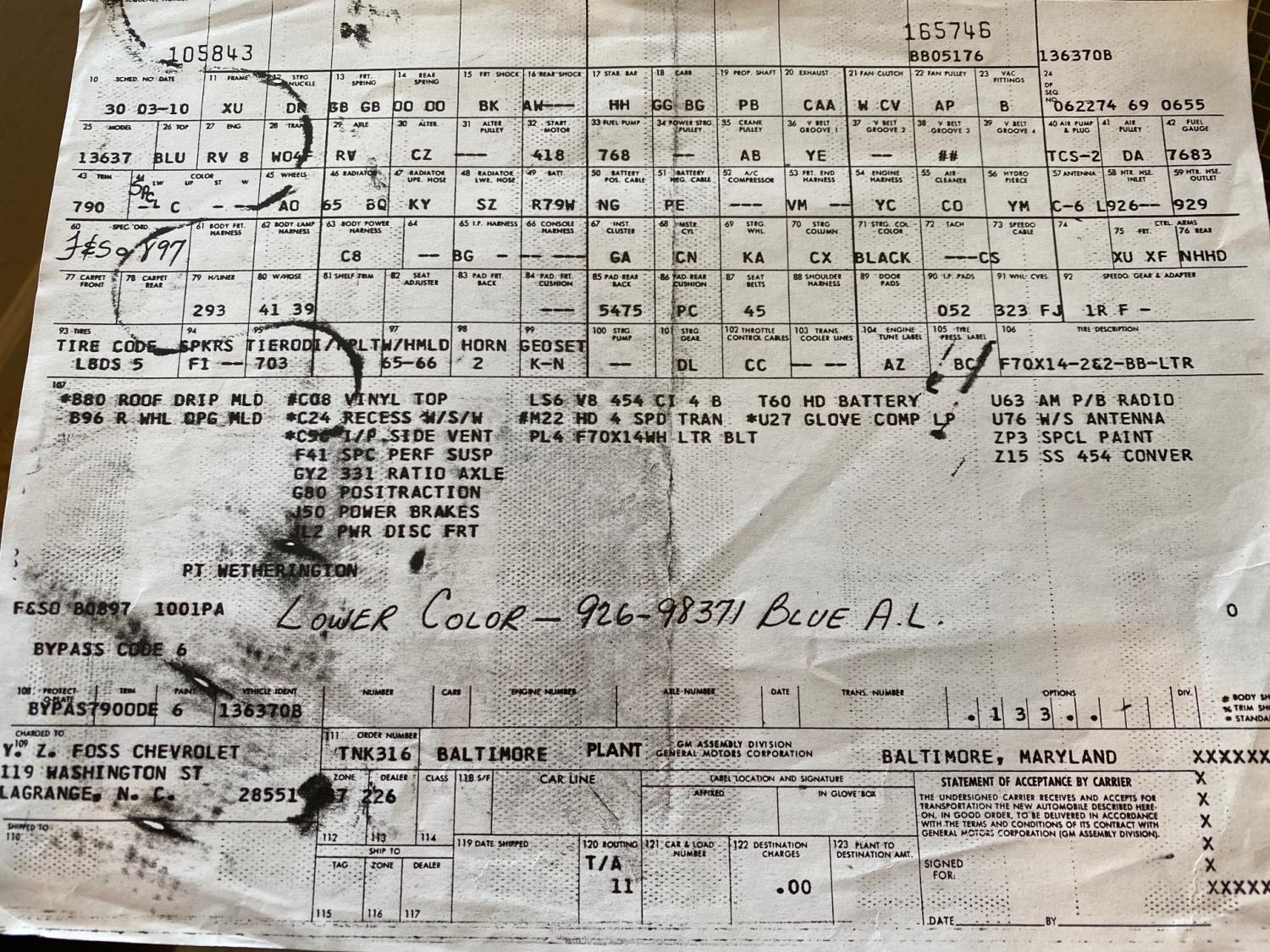

That second link might be what I needed, thanks John.
I see Carolina Blue listed with the old Dupont number 926-98371
That's the same code found on the buildsheet of the 70 Chevelle that rlw68 linked to. Just so happens I have a big picture of that car I can blow up and it visually appears exactly like the blue on my 72. So I'm pretty confident that is the shade I need, and I should be able to cross over that old Dupont number.

I had a LS6 that color and I think the build sheet had it as a Cadillac blue ?
Old 08-02-2020, 01:10 AM
Location: Woodland, ca. US
Posts: 15,980
Thanks: 495
Thanked 4,760 Times in 1,221 Posts
I have a copy of the sheet somewhere.
Old 08-02-2020, 01:20 AM
Posts: 15,980
Thanks: 495
Found it.
The Following 2 Users Say Thank You to Charley Lillard For This Useful Post:
L78M22Rag (08-02-2020), x33rs (08-02-2020)
Charley, is this the same color?
Rob
