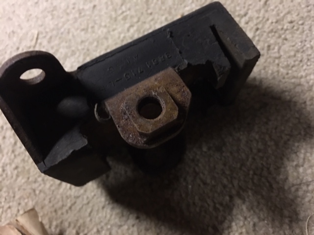

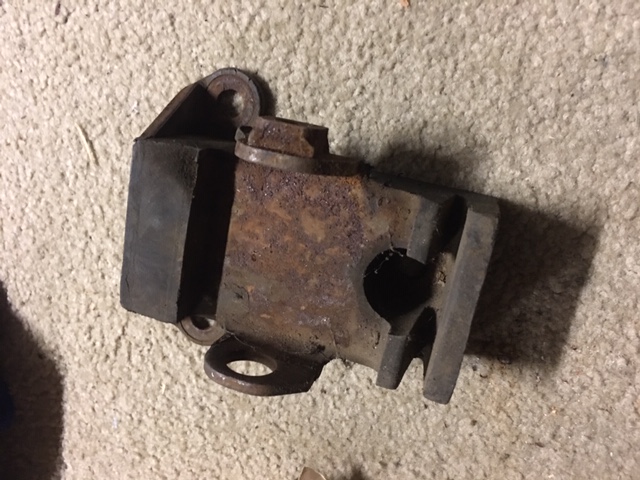

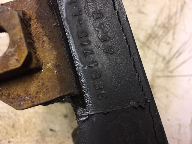

Does anyone know when this type of motor mount got phased out and replaced with the ones that took a loose nut?

I was going to offer to buy it, however I do not need it so I will tell you IT IS VERY RARE!!!!
That is a 65 Z16 or 65 Corvette L78 mount ONLY, they were never offered in SERVICE only production line.
Recent discussion on NCRS about it.
