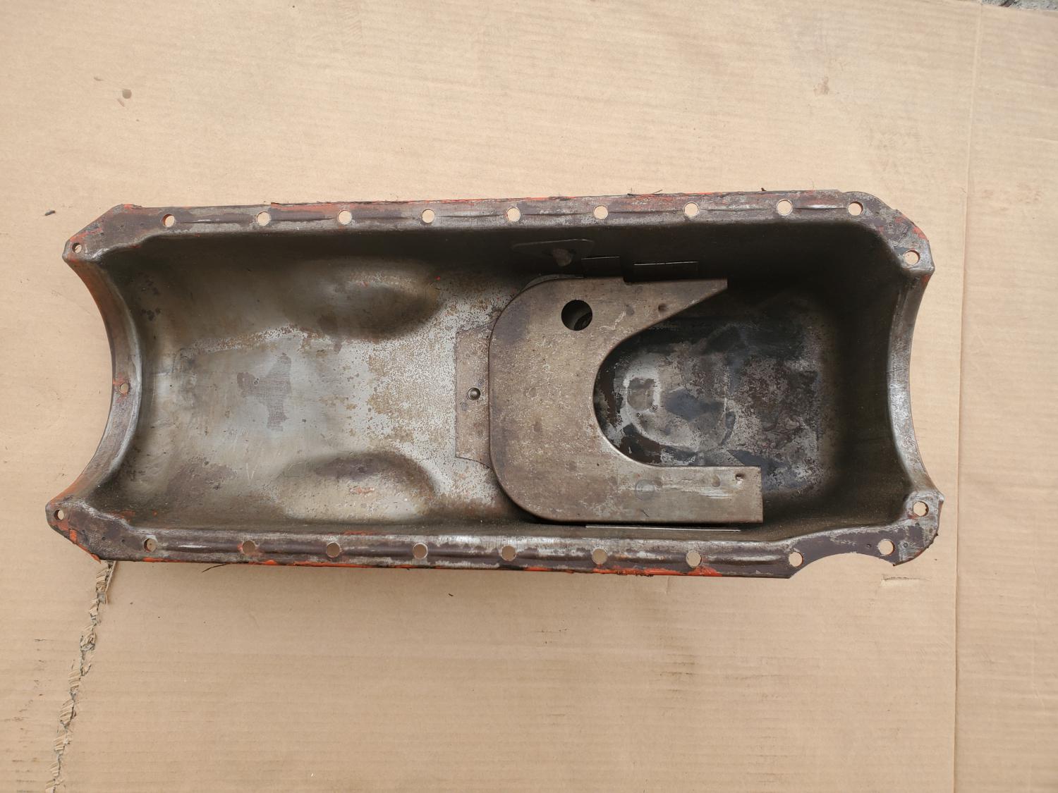

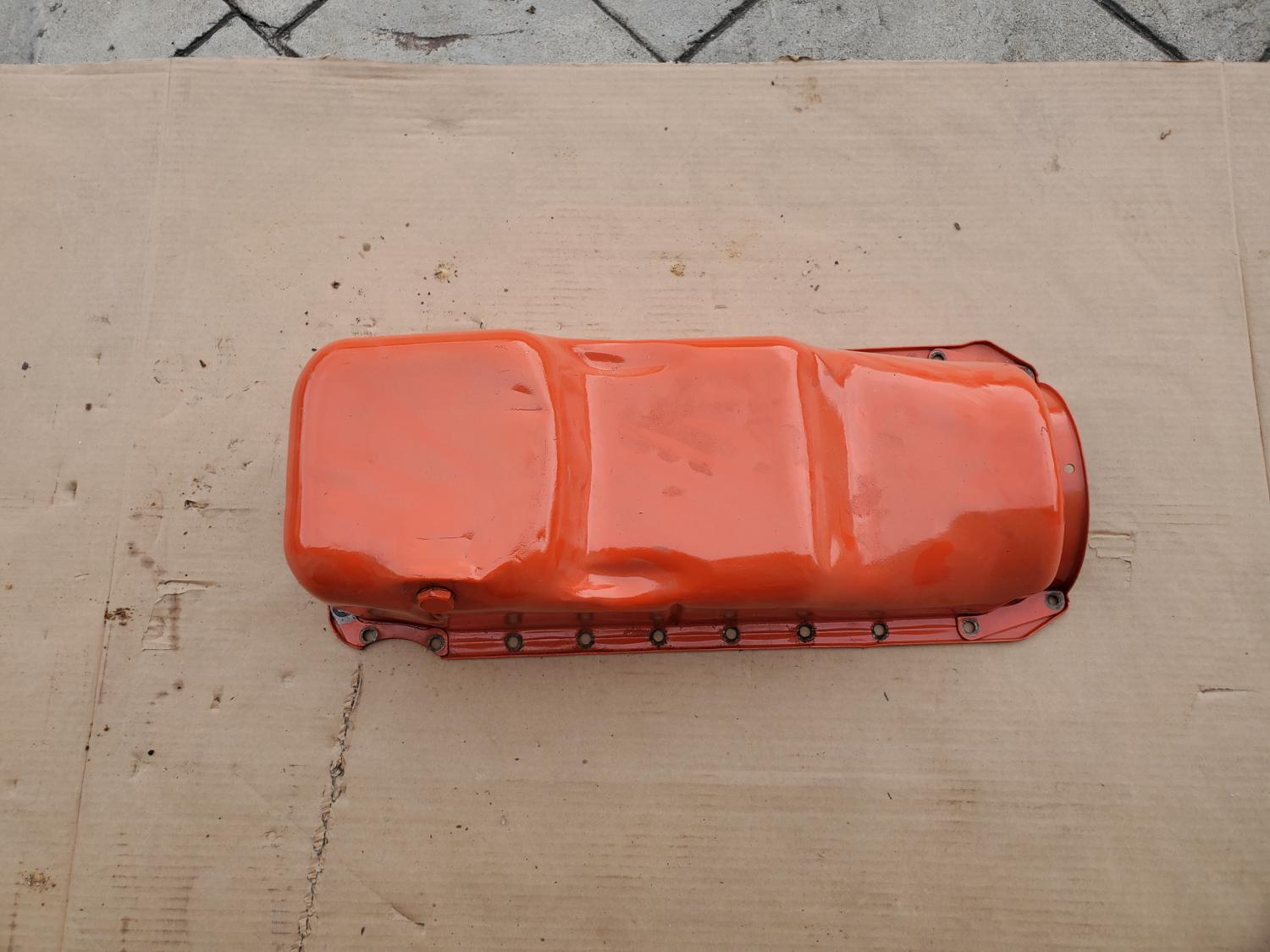

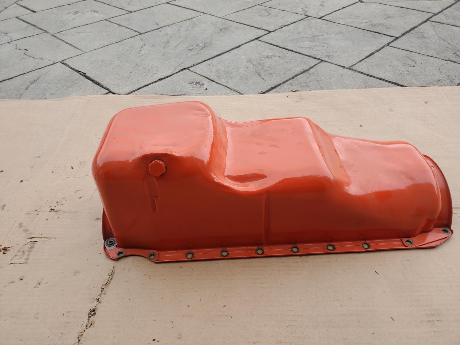

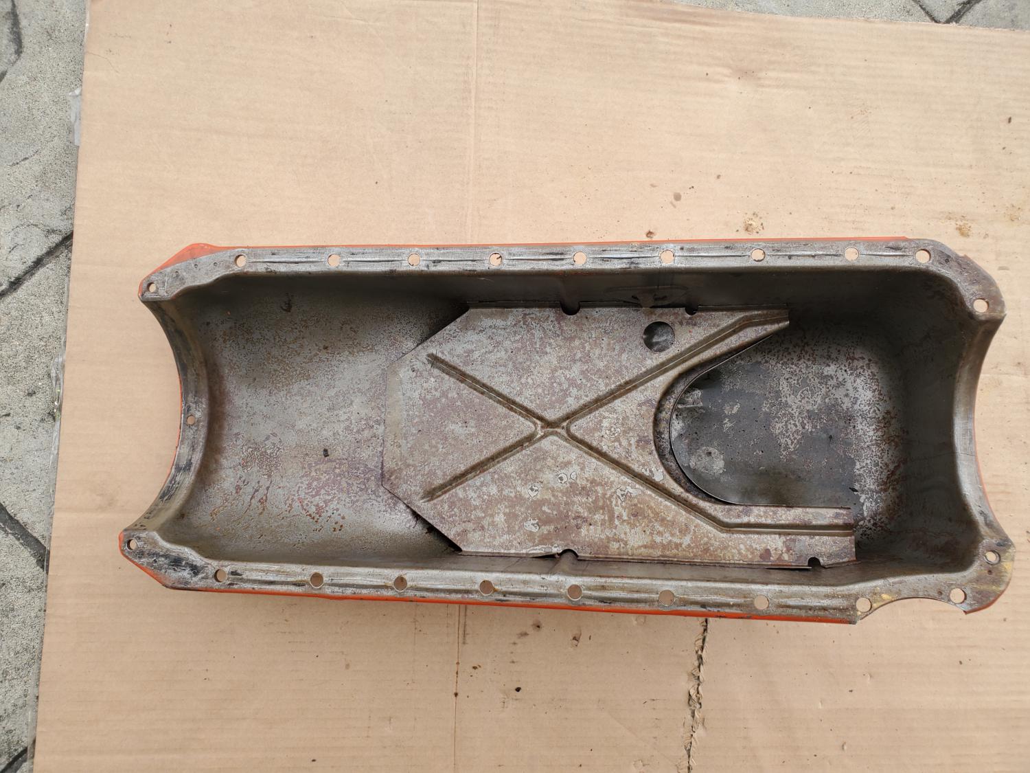

Does anyone know the value on these oil pans? I believe the one is a impala and the other one might be a chevelle or camaro.

The second pan is 66 Chevelle only. It will fit on any Chevelle or Camaro 396/427 but the external stampings and the baffle are technically original/correct for 66 Chevelle only. Once you figure out how much you want for it, please let me know!
The first pan is for big car up to December of 66 (due to the front center bolt hole, which went away in mid Dec. of 66). I don't know if the stampings and baffles changed in the big car pans, and if so whether they changed at the same times as the Chevelle pans. But if they did, that would make this an early 67 only big car pan.
