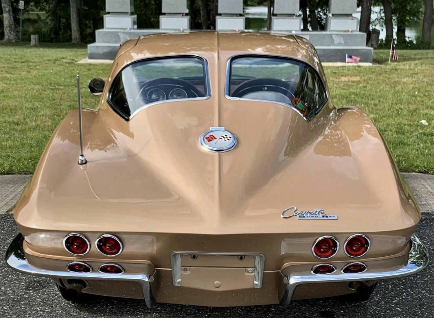

All of my 1964 -66 Corvettes with the back up lights had inner white lenses for the back up lights. This "rare" split window has red back up lights and am wondering how that worked. Also has the wrong PB 1963 Corvette master cylinder.

Amateur resto. What is up with the location of the tail lights? They are inboard inches of where they are on an original car. Two throttle return springs?
Seems like every 63 has or had the 64-style service replacement MC at some point. I have an original 63 MC in need of resto, and had the latest repro MC on my last 63. Very hard to differentiate, and a quick/easy changeout.
It’s almost like it had six tail lights (thanks J&D!) like so many of these cars had done but when it was restored the body shop was told to eliminate the two extra lights . . . . so they removed the outermost lights!
When I first scrolled through these eBay photos, something looked odd about that rear end.
Sharp eye SupremeDeluxe.
This is embarrassing for such a beautiful car.

----I'm sitting about two feet away from the rear end of our 66. Actually didn't see the offset until the subject came up. Then I turned my head about 25 degree's and I think I said "holey s---! I can't imagine a scenario where this is possible......Bill S
