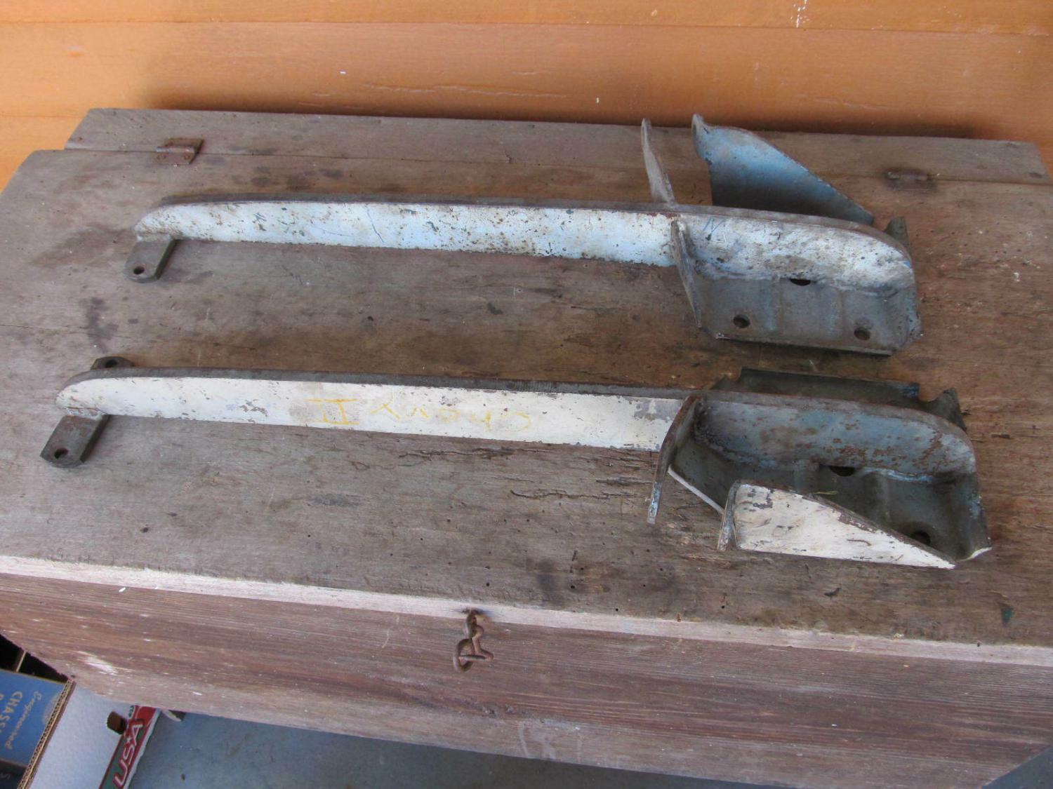

https://www.ebay.com/itm/373812803683
Pair of early design traction bars, something like I had on my first 57 Chevy years ago. Owner is fishing, even suggests they may be for a Chevelle. Chevy II in crayon marked on one of them, but thought someone might be able to identify them by sight.

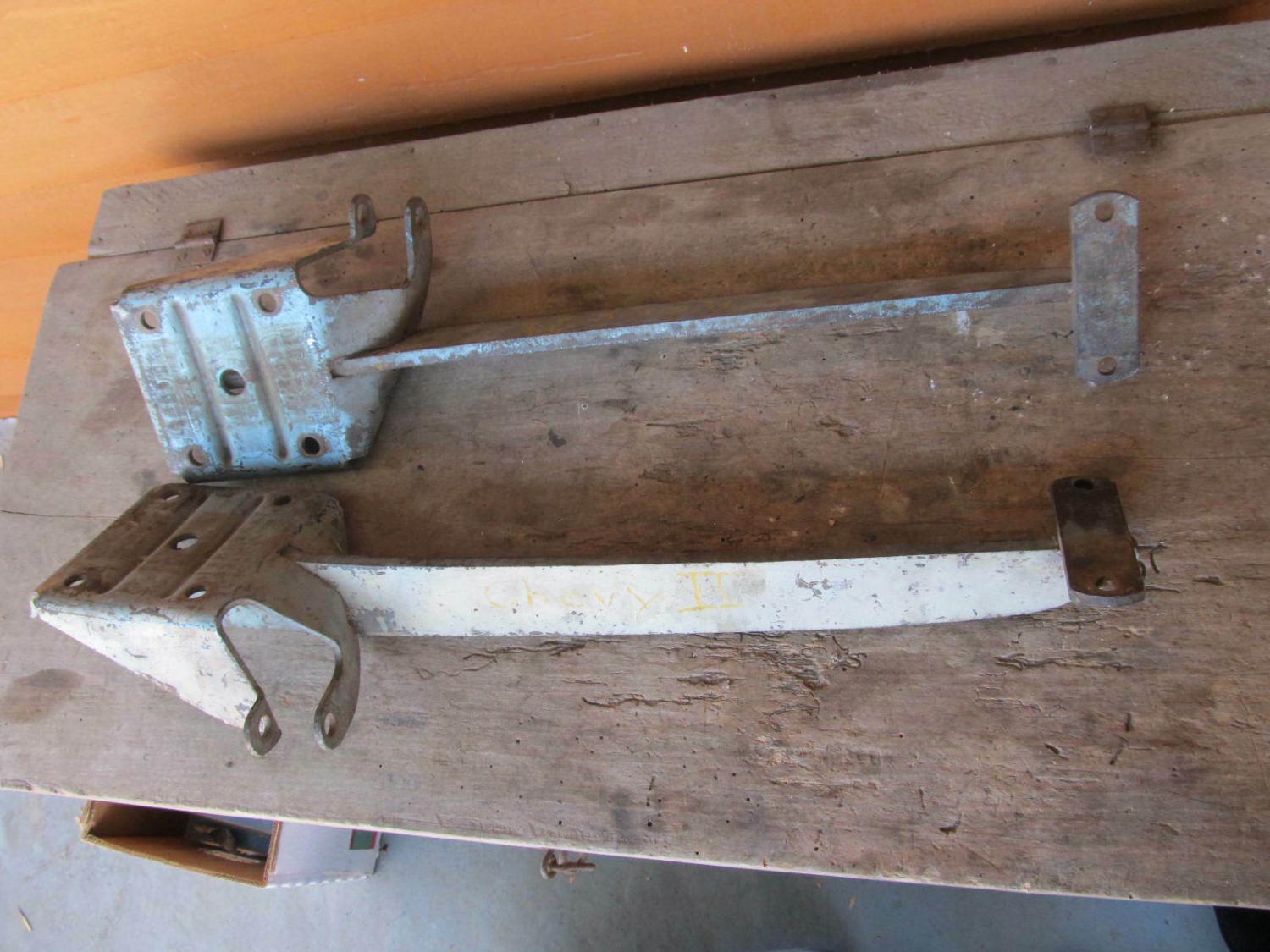

Old 12-03-2021, 02:10 AM
John Brown's Avatar
Location: South Bend, Indiana
Posts: 2,820
Thanks: 455
Here's a picture facing the other way up.
John Brown

Nova/chevy II those look like the Bill Thomas/Nickey traction bars. I know the Bill Thomas where painted blue.
Very cool pieces

With both shock mounts forward of the axle, wouldn't that indicate '67 F body ?
Did any Mopar/Ford leaf spring cars use that arrangement too ?
Trying to "imagineer" a way to bolt them on a Chevelle...

I concur they look to be '67 F-body Bill Thomas traction bars. The color should be like the Pontiac silver-blue engine color. I have a set of these but the front bracket is not as far forward.

Yes, they look like 1967 First Gen Camaro NicKey / Bill Thomas traction bars.
https://www.gss-supercars.com/wp-con...-and-Story.pdf

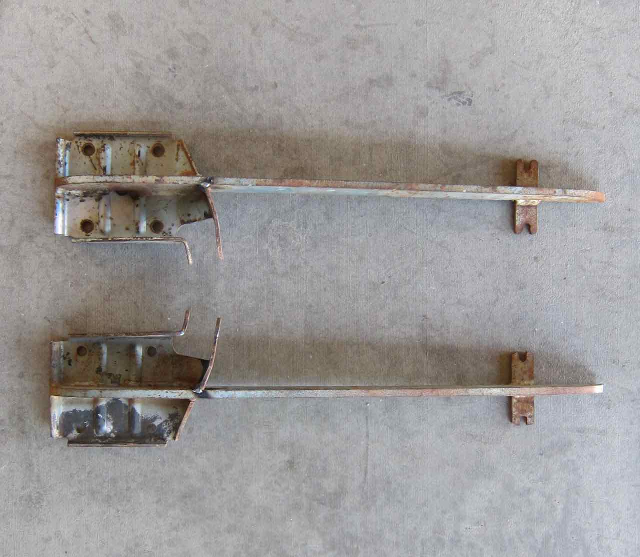

Old 12-03-2021, 09:32 PM
Posts: 12,381
Thanks: 18,512
Thanked 5,609 Times in 2,405 Posts

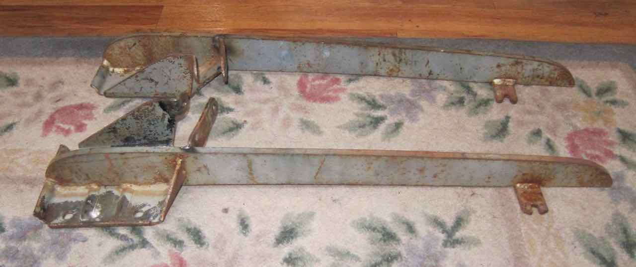

Old 12-03-2021, 09:34 PM
Posts: 12,381
Thanks: 18,512
