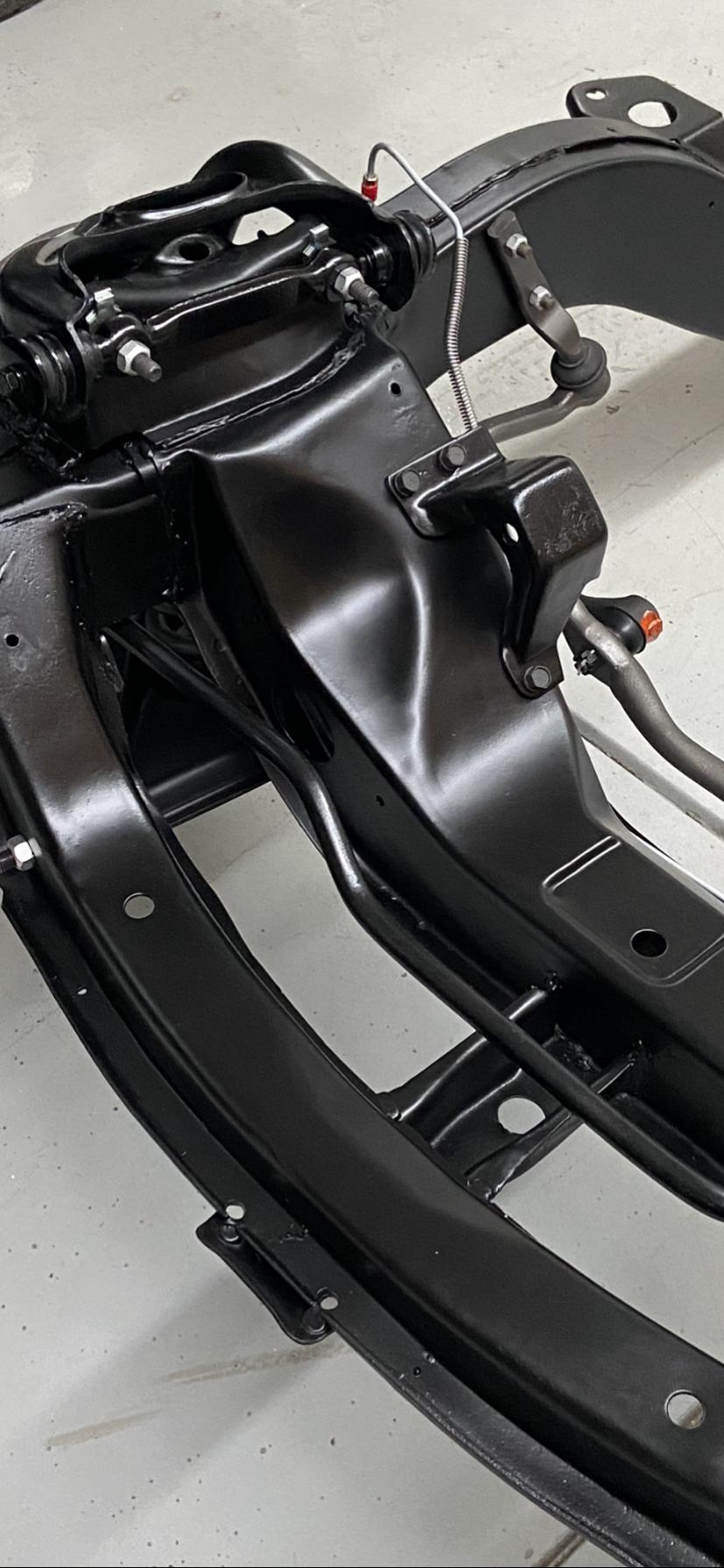

My April in the second week car has the short spoiler. No hole is in the subframe for the center brace and no side braces are used on it. It is screwed on with panhead sheet metal screws from the bottom. It has a textured grain finish too.

My 68 Z/28 has no hole in the subframe either. It is a factory spoiler car. Assm date 03/13/1968...Joe

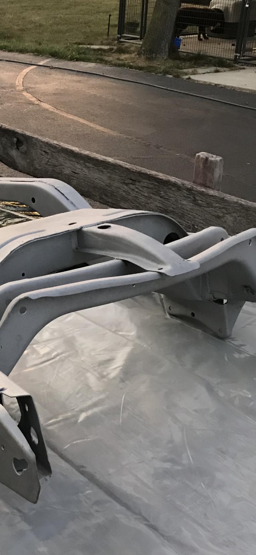

My 68 05B has two holes on the front of the subframe but no centered hole. Thoughts?
