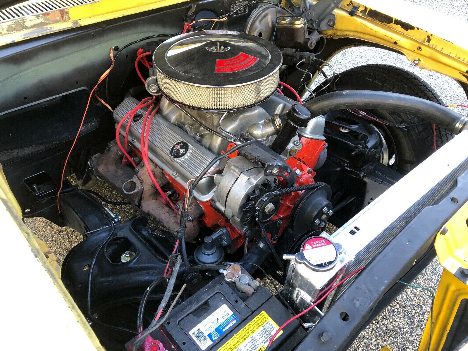

Not 'unmolested,' or a 'survivor,' or any of those endearing terms, but it does look to be a pretty solid project. Not sure what to make of the deck stamp, and the 12-bolt is a garden variety 3.07 open diff....

X77 RS tail panel ?

Saw that. Could have been cut in by a previous owner? (or something's up with the trim tag)

Engine pad is a restamp. Lots of work to do. Rear doesnt look original either. Lots of missing parts.
