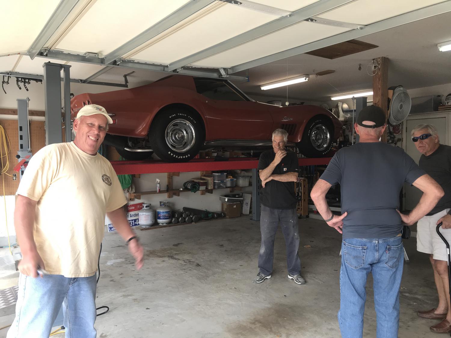

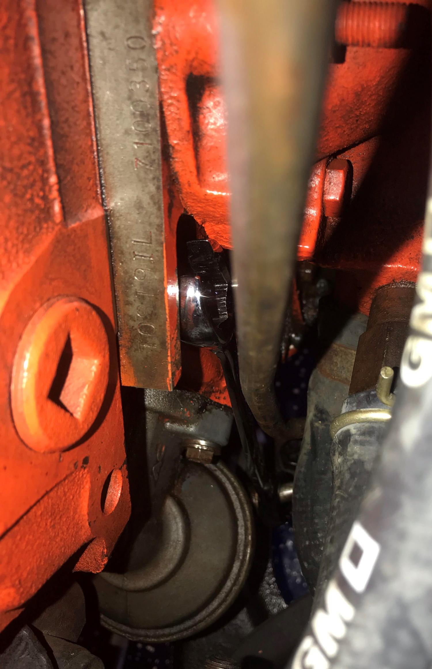

Besides all the other cars we are working on, we took a break for a one owner, original owner 70 SS396 M20 in for a laundry list of mechanical repairs. Extremely nice original car. I located 2 buildsheets in the rear seat while putting in a package tray so that made the owner's day. We also replaced the tires with the correct restoration tire for those that may ask.
Rick Nelson
