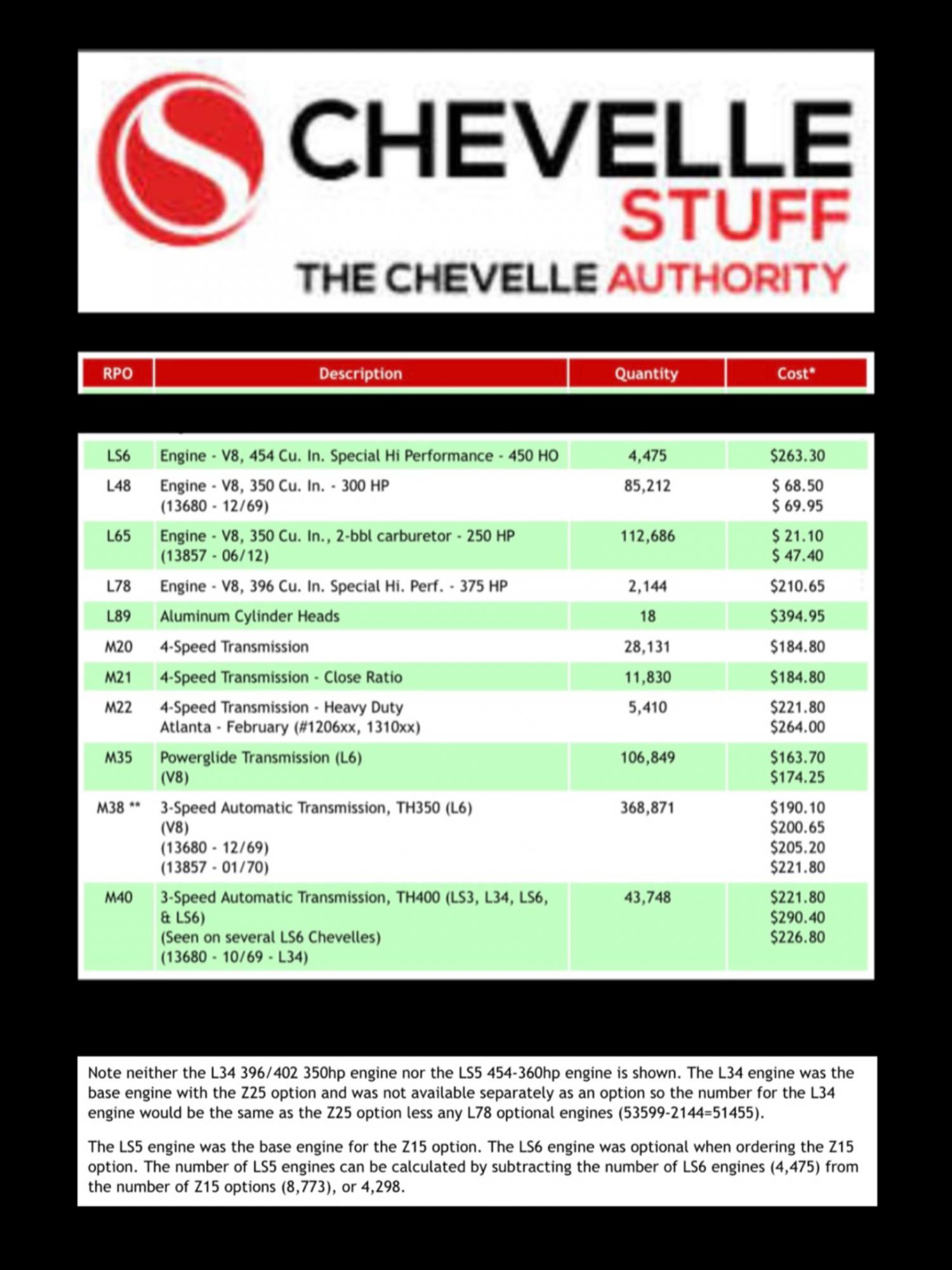

Old 01-14-2023, 04:49 PM
Posts: 12,394
Thanks: 18,649
Thanked 5,675 Times in 2,415 Posts
Highlights of Dale’s page as below pic

Old 01-14-2023, 05:03 PM
WILMASBOYL78's Avatar
Join Date: Jul 2003
Location: new york
Posts: 8,351
Post Engines and Transmissions...
How come there is no listing for the LS-5..??

Old 01-14-2023, 06:02 PM
COPO COPO is offline
Join Date: Mar 2000
Posts: 3,022
Thanks: 400
Thanked 377 Times in 201 Posts
The notes on the bottom of the chart explain why LS-5 is not listed. It is base engine of the Z-15 option therefore was not a standalone option. The LS-6 was an option together with the Z-15 option.
