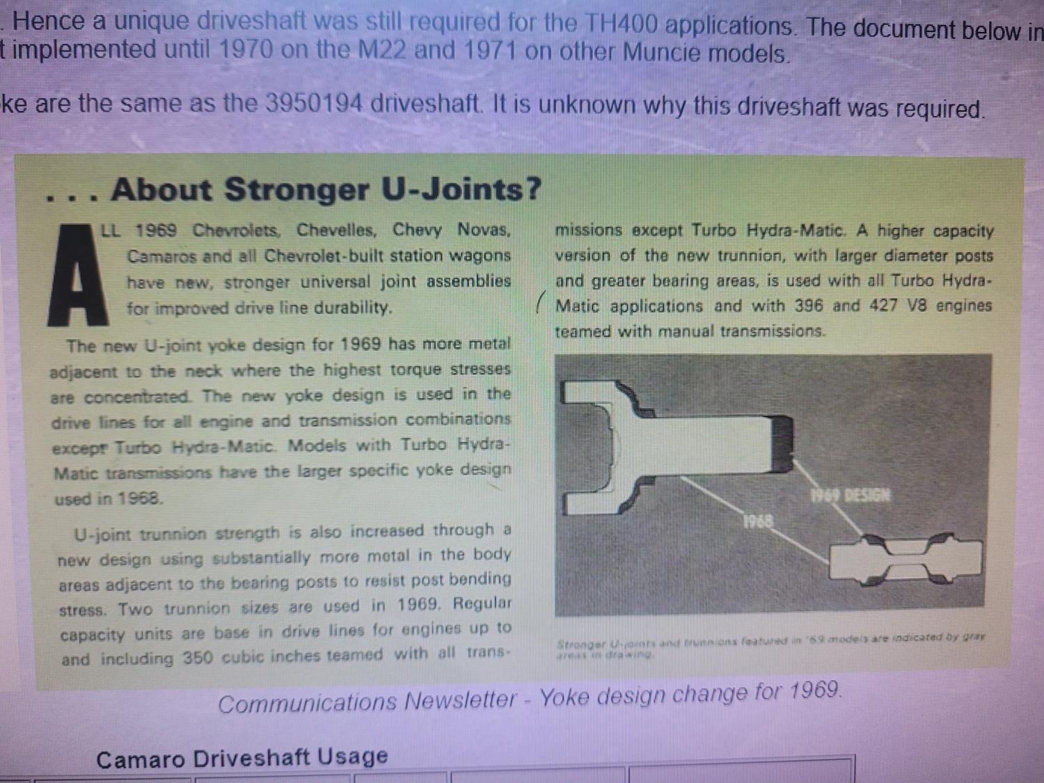

I need an original transmission yoke for a 69 turbo 400 camaro. Different than 68. Any help appreciated. Thanks.
Attachments - The Supercar Registry 16752691503341093118916473143872.jpg 16752691045493491337586201111249.jpg 16752690840639066676291321633633.jpg

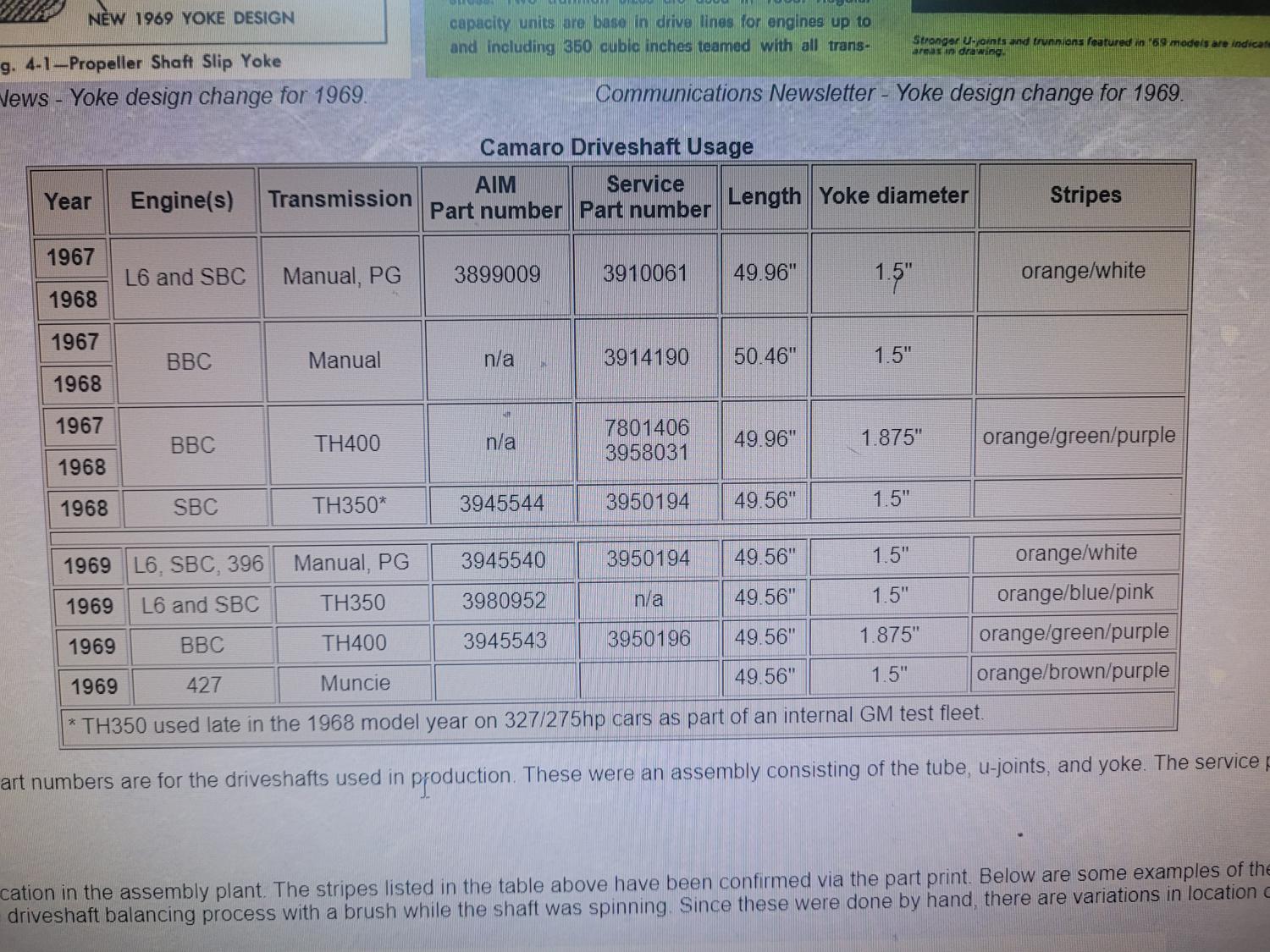

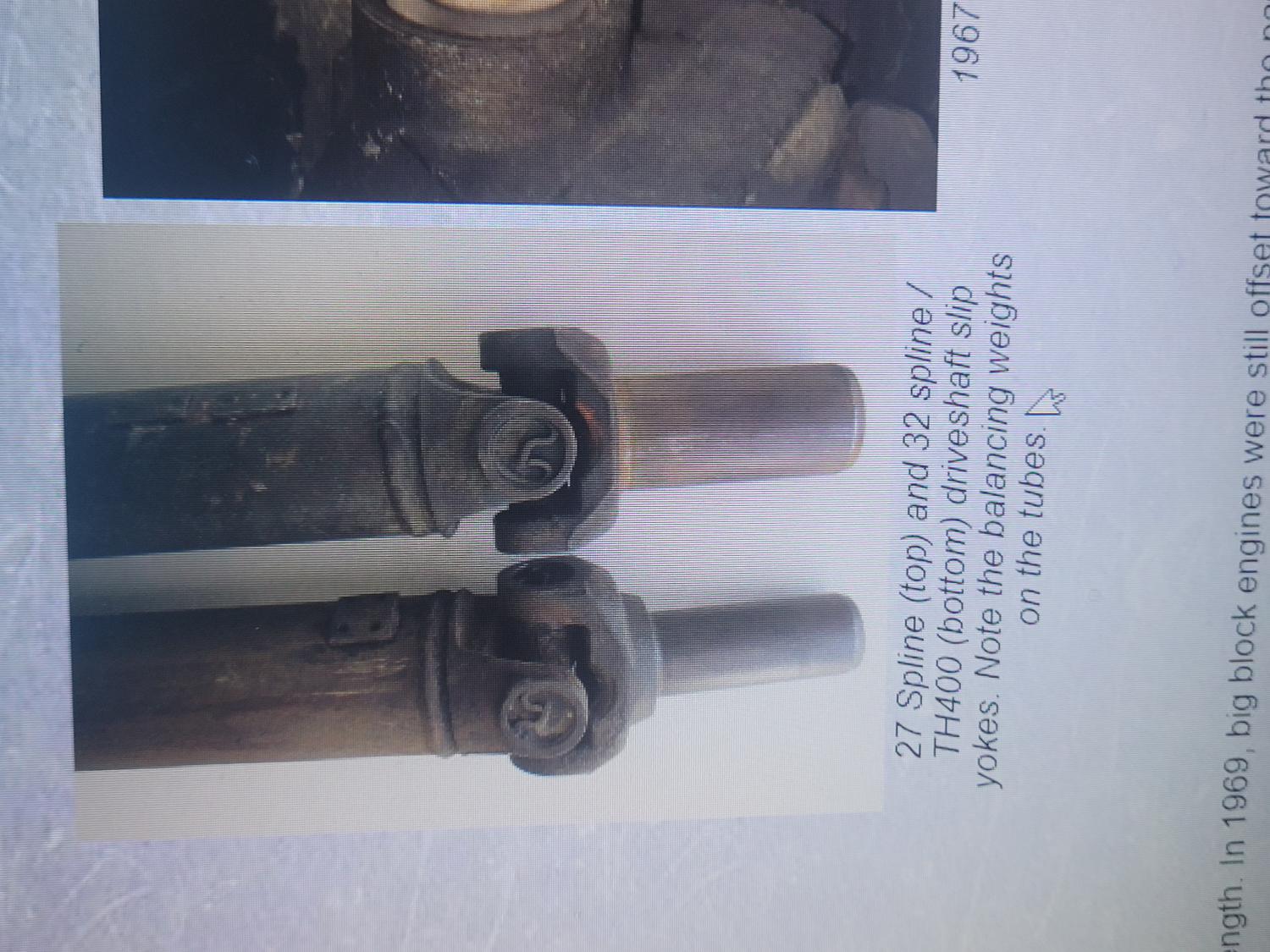

Here are some pi tures from CRG website. 1969 400 yoke is 1 and 7/8 diameter.

The 67 68 ujoint had the nylon injected retainers but the 69 400 yoke was set up for external snap rings.
