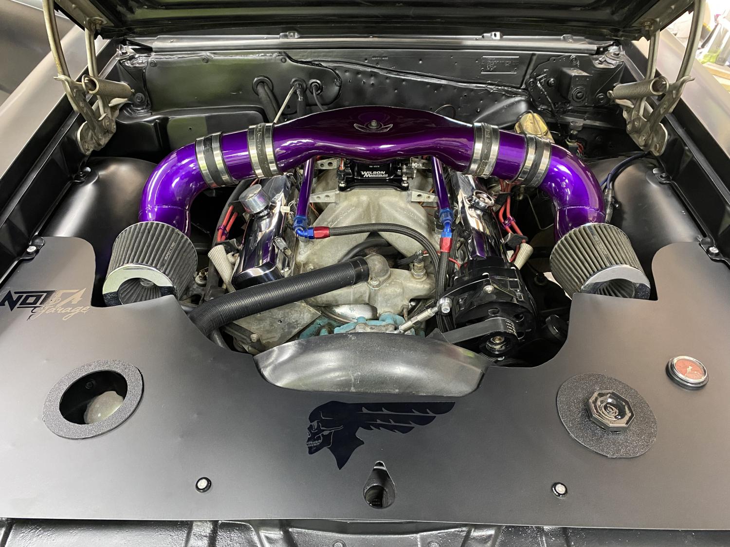

Hey Dan, it may be more custom than you are looking for but I have had great luck with this type of clamp. It is only a one time use but clamps very tight and barely visible. It is a shrink type and semi hard plastic tube that you use a heat gun to shrink. Comes in a variety of sizes and available at most automotive parts stores. Pictured installed on lower radiator hose at radiator and joining the heater hoses.

To clean up the look of a screw type clamp slide some heat shrink tubing over it. Hides most of it. The short hose at the throttle body has two gates clamps with heat shrink tubing. Had people ask what type of clamp it was.
