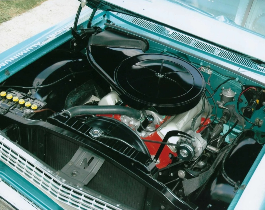

These cars although RPO's, were purpose built for strictly racing. Non essential items were not available to reduce weight such as; radio, heater, sound-deadner.
This package was quite potent especially when Frank Sanders was behind the wheel, winning 19 of 20 races he entered in 1963.
Today it is owned by Roger Sortino a fantastic caretaker!
Here are a few HD components:
Aluminum components:
  • hood
  • fenders
  • bumpers
Engine-427:
  • stroker crankshaft
  • compression (13.5:1)
  • heads with larger ports
  • dual four-barrel carbs
  • 427 cubic inches-430 horsepower.

thanks Steve - what a thumper. What trans did Chevy use in ‘63 to handle the torque of this 427?
4 Speed Manual Close Ratio
Old 09-13-2022, 01:03 AM
Posts: 36,633
Thanks: 3,506
Perhaps the 427’s greatest improvement over the 409 was in the cylinder heads and intake manifold. Like the high-performance versions of the 409, the 427 used 2.19-inch intake and 1.72-inch exhaust valves, but the 427’s head castings were taller. This allowed the ports to be located higher for a straighter path from the intake into the combustion chamber. The dual-carburetor aluminum intake manifold was unique, too, and made in two pieces: the lower part served as the lifter valley cover and contained the water jackets, while the upper portion housed the raised intake runners. A pair of Carter AFBs topped the intake and drew air through a special cowl-induction inlet that fed the air cleaner.
Chevrolet reportedly made 57 Z-11s before GM pulled the plug on all of its racing programs. The 427 represents the pinnacle of W engine performance development and is legendary among enthusiasts of the breed today.

430 Horsepower?

Per Colvin’s 60-64 “By the Numbers” chapter on the Z-11, they were all built with close ratio Borg Warner T10 with Inland shifters. It makes sense, as the first Muncie 4 speeds didn’t initially ship to production until February 6th, 1963. (Shipped to Baltimore plant to be put into full size Chevrolets, NOT Corvettes-The earliest Corvettes to get Muncies are built in the May/June 1963 timeframe)
I don’t think Mr. Sortino owns the Sanders car any longer. I appraised it around 2010 here in WA and then the next time I saw it was in the Mecum display at MCACN a few years later. I do have to say, its probably my favorite Z11 after seeing it in all of its unique aqua/aqua original glory.
